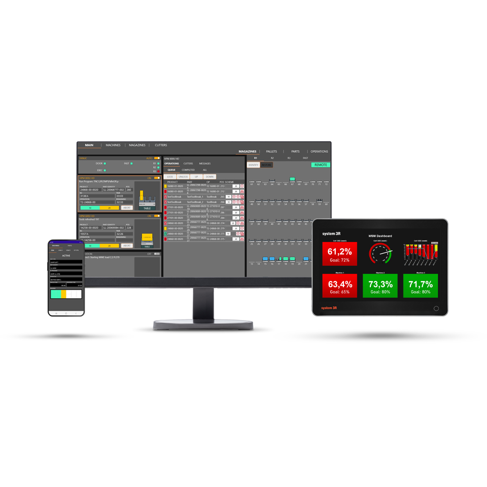

WorkShopManager 5 (WSM5)
Preparation
Product Data Manager
  • Create an order
  • Retrieve offset values
Execution
CellManager
  • Creates priority lists
Monitoring
Monitor and Dashboard
  • Display status of all cells
WorkShopManager 5 - WSM 5
  • Increased process security
