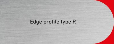

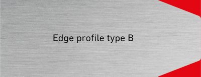

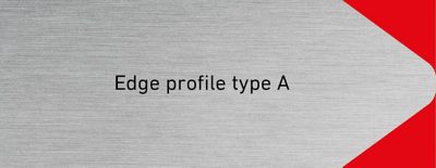

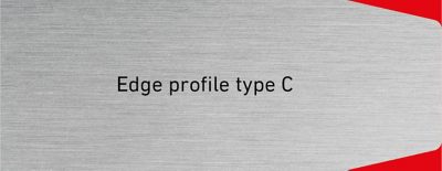

Throughout the manufacturing process, SiC wafers, generally 6 to 8 inches in size, are handled multiple times. Their extreme hardness and brittleness significantly increase the risk of chipping or breakage. To mitigate this risk, SiC wafers are given edge profiles (usually R or F-type) according to SEMI standards. These profiles are typically created using diamond wheel grinding, which faces issues such as diamond wheel wear, uneven grinding, and improper angle formation. This current process is time-consuming and results in high manufacturing costs.
