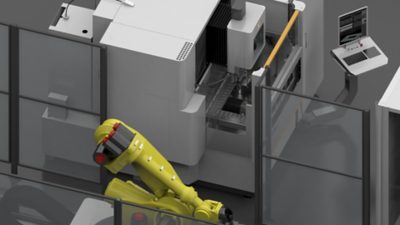

Reduzca las intervenciones manuales y aumente el tiempo de procesamiento con la funcionalidad de soldadura automática en masa (Automatic Slug Welding, ASW) para soldar a la cavidad y eliminar fácilmente el núcleo antes de realizar cortes de acabado y la gestión automática en masa (Automatic Slug Management, ASM) que no requiere presencia del operador. Ambas funcionalidades reducen la presencia del operador delante de la máquina.

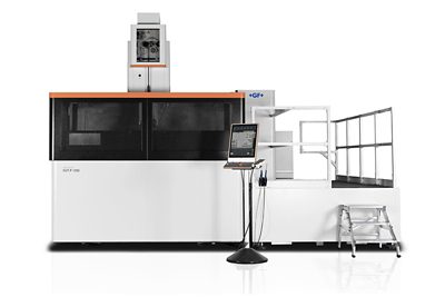

CUT P 350 Pro / CUT P 550 Pro / CUT P 800 Pro

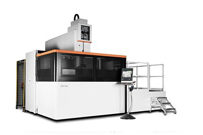

CUT P 1250
Especificaciones
CUT P 350 Pro
Travel X, Y, Z *
350 x 250 x 220 mm
13.77 x 8.66 x 8.66 in
Min. surface roughness RA0.08 μm
Max. taper angle / height
± 30/220 (45/220 optional)° mm
± 30/8.66 (45/8.66 optional)° in
Max. workpiece dimensions *
1000 x 550 x 220 mm
39.37 x 21.65 x 8.66 in
Max. workpiece weight
750 kg
1653 lbs
Workpiece and electrode
Travel U, V **
350 x 220 mm
13.77 x 8.66 in
Wire diameters
Max. wire spool weight8 (25 optional)  kg
CUT P 550 Pro
Travel X, Y, Z *
550 x 350 x 400 mm
21.65 x 13.77 x 15.75 in
± 30/400 (45/400 optional)° mm
± 30/15.75 (45/15.75 optional)° in
1200 x 700 x 400 mm
47.24 x 27.56 x 15.75 in
1500 kg
3307 lbs
Travel U, V **
550 x 350 mm
21.65 x 13.77 in
Wire diameters
CUT P 800 Pro
Travel X, Y, Z *
800 x 550 x 510 mm
31.5 x 21.65 x 20.07 in
Min. surface roughness RA0.1 μm
± 30/510 (45/510 optional)° mm
± 30/20.07 (45/20.07)° in
1300 x 950 x 510 mm
51.18 x 21.65 x 20.07 in
3000 kg
6614 lbs
Travel U, V **
800 x 550 mm
31.5 x 21.65 in
Wire diameters
0.15-0.33 mm
0.06-0.013 in
Max. wire spool weight25 kg
CUT P 1250
Travel X, Y, Z
1250 x 850 x 100-800 mm
49.2 x 33.5 x 3.9-27.56 in
Min. surface roughness RA0.2 μm
30/800 °  mm
30/31.5 ° in
2300 x 1300 x 800 mm
90.6 x 51.2 x 31.49
6000 kg
13228 lbs
Travel U, V
1250 x 850 mm
49.2 x 33.5 in
Wire diameters
0.15-0.33 mm
0.006-0.013
Max. wire spool weight **
25-45 kg
55-100 lbs
