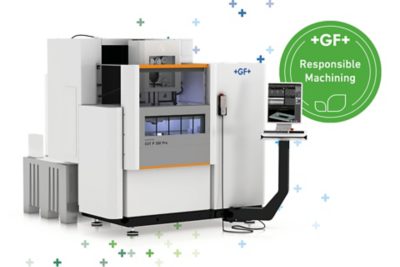

Sustainability
Discover our innovations that allow our new Wire-Cutting EDM machines to achieve reductions of up to 30% in daily energy consumption, compared to the previous generation.

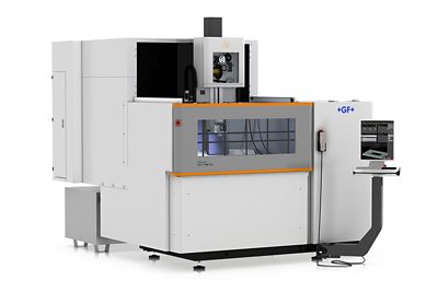

CUT P 350 Pro
Travel X, Y, Z *
350 x 250 x 220 mm
13.77 x 8.66 x 8.66 in
Min. surface roughness RA 0.08 μm
Max. taper angle / height
± 30°/220 mm (45°/220 mm optional)
± 30°/8.66 in (45°/8.66 in optional)
Max. workpiece dimensions *
1000 x 550 x 220 mm
39.37 x 21.65 x 8.66 in
Max. workpiece weight
750 kg
1653 lbs
Travel U, V **
350 x 220 mm
13.77 x 8.66 in
Wire diameters
Max. wire spool weight 8 (25 optional)  kg

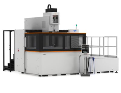

CUT P 1250 Pro
Travel X, Y, Z
1250 x 850 x 100-800 mm
49.2 x 33.5 x 3.9-27.56 in
Min. surface roughness RA 0.2 μm
30°/800 mm
30°/31.5 in
2300 x 1300 x 800 mm
90.6 x 51.2 x 31.49
6000 kg
13228 lbs
Travel U, V
1250 x 850 mm
49.2 x 33.5 in
Wire diameters
0.15-0.33 mm
0.006-0.013
Max. wire spool weight **
25-45 kg
55-100 lbs
