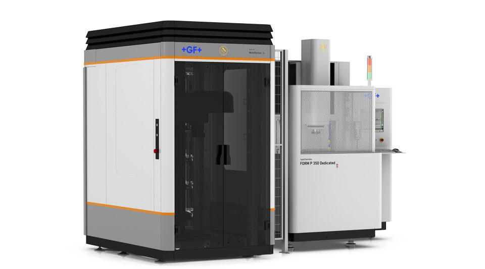

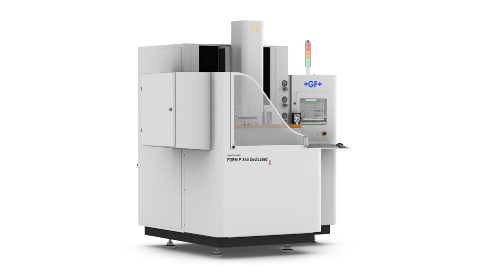

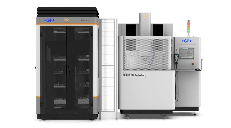

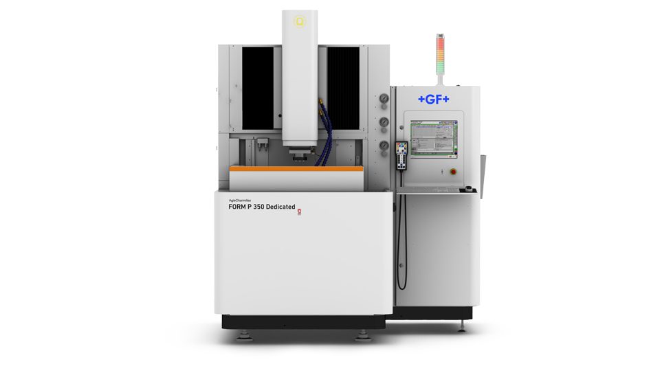

AGIE CHARMILLES FORM P 350 Dedicated
Manufacturing connector molds requires high speed and high precision as well as high machining performance. To support mold makers, AGIE CHARMILLES developed the new AGIE CHARMILLES FORM P 350 Dedicated, a tailored, ready-to-use die-sinking solution for a fast and reliable connector mold inserts manufacturing.
AGIE CHARMILLES FORM P Series
AgieCharmilles FORM P 350 Dedicated
