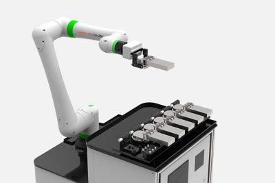

Wire EDM application and AMR ld-90
CoBot C6-20L
Onboard magazine
6 position with Macro WEDM

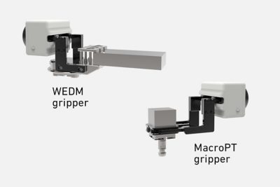

Example of grippers
Example of grippers
Depending on the tooling to use, we have electrical grippers approved for collaborative robots (Zimmer/Schunk). This to work safely, alongside the operator.

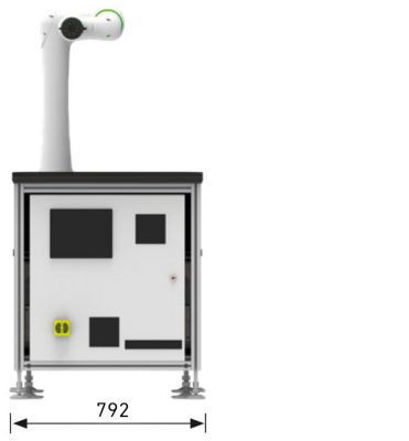

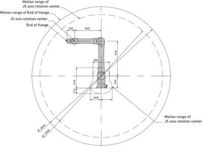

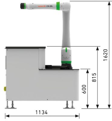

Technical drawings (mm)
Side view
Side view
Back view
Back view

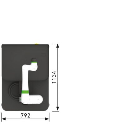

Top view
Top view
Technical drawing cobot

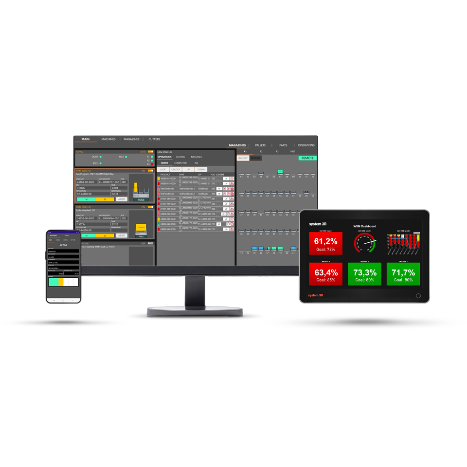

WorkShopManager 5 (WSM5)
Preparation
Product Data Manager
  • Create an order
  • Retrieve offset values
Execution
CellManager
  • Creates priority lists
Monitoring
Monitor and Dashboard
  • Display status of all cells
Cell
  • Increased process security
