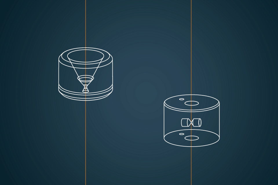

Easily exchangeable open and closed guides
Interchangeable cartridge
The guides are designed as a cartridge that can be easily and quickly exchanged
Maximum flexibility
You can choose the right guide for each different application

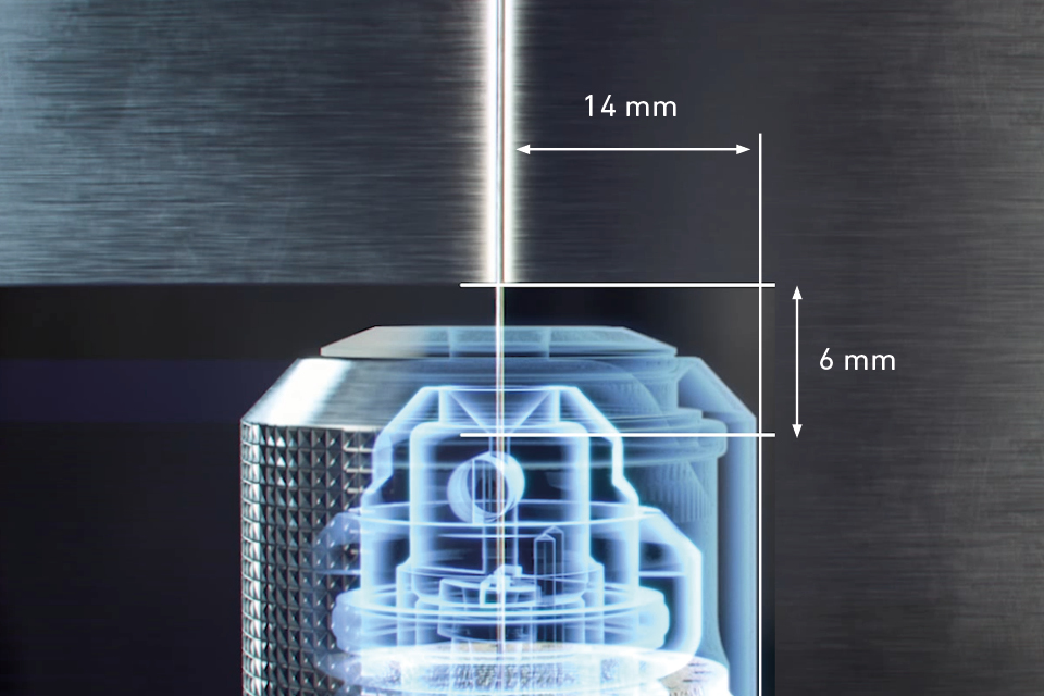

Extreme accuracy
The distance from guide to workpiece is reduced, improving the wire stability.

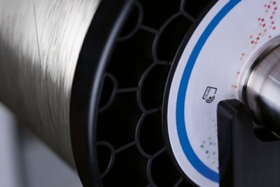

SMART Wire
SMART wire spools are equipped with radio frequency identification (RFID) chips to store wire characteristics and traceability-related data. This feature equips the CUT X and makes it truly a smart solution!
- Improve your production process
- Achieve full traceability
- Share technical issues in an efficient manner
