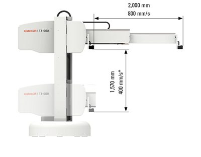

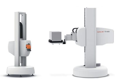

The Transformer T3 exist in 4 models. 100/150/200/600 kg. The T3-600 can lift and handle a Total weight of 600 kg including gripper, pallet and workpiece.
The Transformer T3 can serve All technologies like EDM,WEDM Milling,Laser,CMM,washing and grinding.

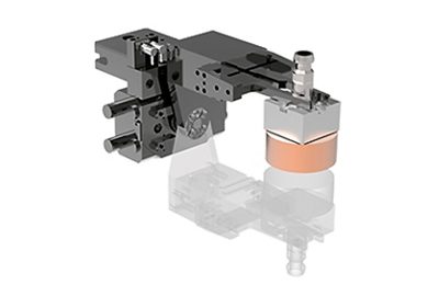

Our Transformer concept is designed to handle a wide variety of tools; everything from the small Macro (54 x 54 mm) to the large DelphinBIG (800 x 800 mm). Other manufacturers’ tools can also be handled.

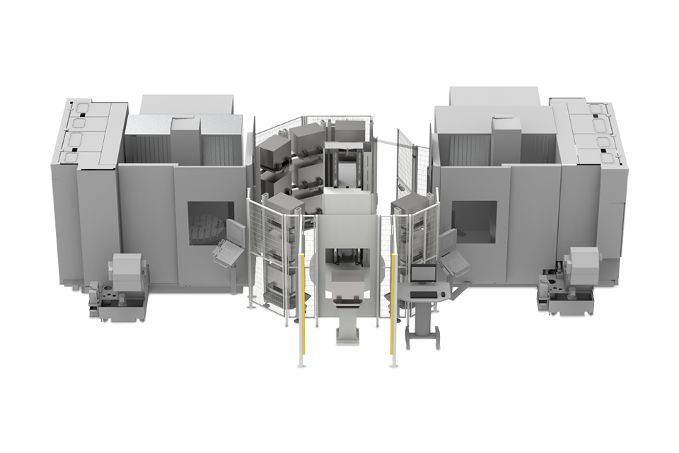

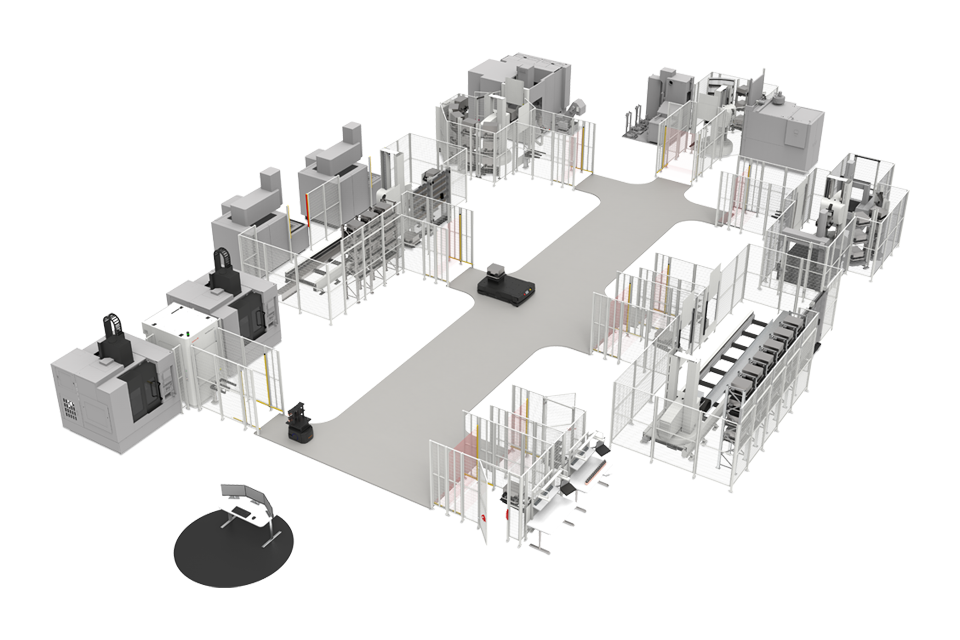

In each automation cell, all the machines and accessories have chucks suitable for getting pallets from the manipulator.
The automation cell’s desired storage capacity is achieved by using a suitable number of magazines and adapting the layout appropriately.

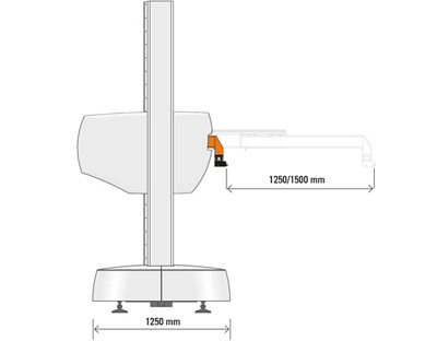

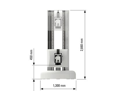

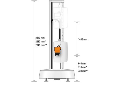

| Manipulator | |

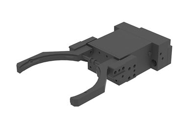

| Payload (workpiece, pallet and gripper) | 600 kg |
| Z axis reach | 2,000 m (up to 800 mm/s) |
| Z axis reach | 1,500 m (up to 400 mm/s) |
| C axis range | 0-340 ° (up to 90 °/s) |
| Air pressure and flow | 6 bars (± 1 bar), 150 l/min |
| Power supply | Three phase (200, 230, 400 or 500 V AC |
| Frequency | 50/60 Hz ±1% |
| Power consumption | <4,0 kVA |
| External fuse | 20 Amps, type D |
| Electrical interface | RS-232 Standard - Parallel port 24V Isolated Standard - RS-422/485 option |
| Floor requirements | Concrete quality, C20/25; thickness, > 180 mm thick (for fixing through anchors); planarity, < 5 mm/m |
| Temperature | Operating temperature, +5°C to +30°C (control cabinet) |
| Humidity | RH, max. 95% |
| Noise level | < 77 dB (A) ISO/DIS 11201 |

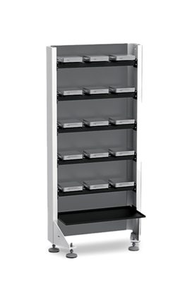

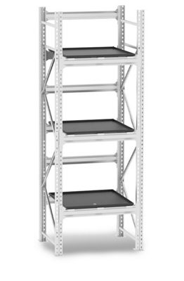

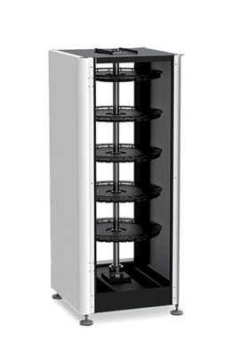

Magazines are available in two basic designs: rack and rotary.
Each magazine unit consists of a number of shelves (determined by the height of the workpieces in question).
| Rotary magazine |
| Tooling |
Positions* | Size in mm (in) |
| Dynafix |
4 5 |
320 x 320 (12.5 x 12.5) 290 x 290 (11.4 x 11.4) |
| GPS 240 |
4 5 6 |
320 x 320 (12.6 x 12.6) 290 x 290 (11.4 x 11.4) 260 x 260 (10.2 x 10.2) |
| Macro-Magnum | 8 10 12 |
210 x 210 (8.27 x 8.27) 185 x 185 (7.28 x 7.28) 160 x 160 (6.3 x 6.3) |
| GPS 120 |
12 | 160 x 160 (6.3 x 6.3) |
| Macro | 36 | 65 x 65 (2.56 x 2.56) |

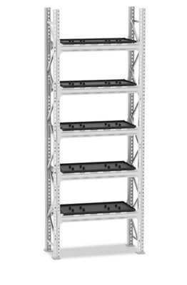

| Full rack magazine |
| Delphin 400x400 |
1 2 |
700 x 500 (27.56 x 19.68) 400 x 400 (15.75 x 15.75) |
| Dynafix | 1 2 |
| GPS 240 | 2 3 |
400 x 400 (15.75 x 15.75) 275 x 275 (10.83 x 10.83) |
| Macro-Magnum | 4 5 |
210 x 210 (8.27 x 8.27) 170 x 170 (6.7 x 6.7) |
| Macro 116 | 6 | 150 x 150 (5.9 x 5.9) |
| GPS 79 | 10 | 95 x 95 (3.74 x 3.74) |
| Macro |
12 |
70 x 200 (2.75 x 12.2) |
| Half rack magazine |
| Tooling* |
Pos.** | Size in mm (in) |
| Delphin 498 x 498 | 1 | 500 x 500 (19.68 x 19.68) |
| Dynafix |
1 |
480 x 400 (18.9 x 15.75) |
| GPS 240 |
1 |

* Positions per level. Maximum workpiece height is determined by the number of levels.
Optionally available with rotary magazines: Rapid ID scanning.
Optionally available with rack magazines: Additional shelves. Door for loading from behind.
