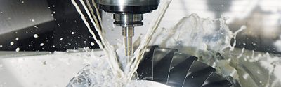

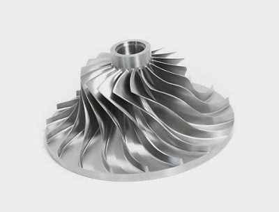

Aerospace impeller
Ideal for aerospace and energy impeller machining, the MIKRON MILL P 800 U is equipped with high-dynamic 5-axis torque motors, delivering precise and stable machining of complex geometries with tight tolerances.​

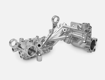

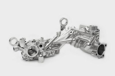

Motorsport gearbox manifold body
Ideal for complex 5-axis motorsport parts, the MIKRON MILL P 800 U delivers precise machining and tight tolerances on materials from hard alloys to aluminum in a single setup.​

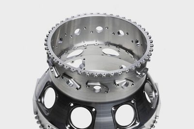

Aerospace turbine casing
Ideal for complex 5-axis defense components, the MIKRON MILL P 800 U delivers high dynamics and stable, stiff construction with simultaneous turning and multi-axis functions in a single setup.​

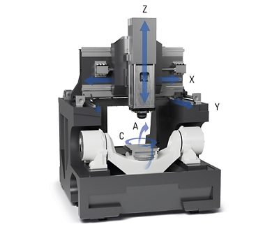

Mechanical design
Robust and stiff for unapparelled dynamism​
The MIKRON MILL P 800 U features a symmetrical gantry design with cooled key components, delivering exceptional stiffness and unparalleled dynamic performance for demanding 5-axis manufacturing.​​
•    Full twin-drive gantry​
•    Direct drive motor for tilting and swiveling​
•    1.7 g axis acceleration​
•    61 m/min axis feedrate ​
•    Up to 1,000 kg payload​

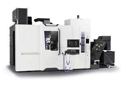

The machine that grows with your needs​

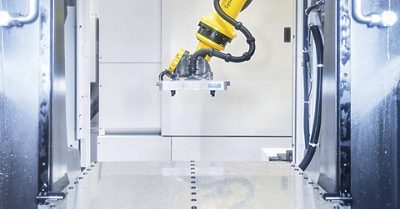

The most compact automated layout in its range​
The MIKRON MILL P 800 U S offers the best complete automation solution per square meter in its class. Quickly and easily connect a second, or more, machine to increase your workshop’s productivity.​

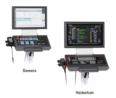

Boosted numerical control​
The MIKRON MILL P 800 U S can be equipped with either the Heidenhain TNC 7 or the Siemens Sinumerik ONE control system. Both HMIs are enhanced by an internally developed and patented Smart Machine modules, designed to boost productivity and elevate machining performance to the next level.

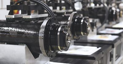

High-quality Swiss made Spindle​
Precision engineered for extreme micromachining
STEP TEC high-speed Spindles use premium components and advanced thermal design for stable, precise, vibration-free micromachining at high speeds. Swiss-made in-house for unmatched quality, ideal for automotive, electronics, and medical applications.
Spindle: power and torque graphs
OptiCool spindle design
OptiCool
STEP TEC’s OptiCool Spindle series ensures not only that the Spindle remains thermally stable, but that natural heat transfer to the Spindle support (e.g., Z axis) is limited to the lowest amount possible, in order to preserve the machine’s geometry.​
