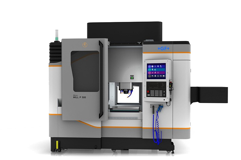

Designed for automation and robust, long-term precision, the MIKRON MILL P 500 vertical 3-axis milling machine delivers consistent performance you can count on - every part, every day. The MILL P 500 gives manufacturers an affordable path to achieve the highest part quality and throughput. It’s specifically designed for challenging mold, die and electrode milling applications in the information and communications technology (ICT) and electronics industries, as well as automotive, medical, packaging and home appliance applications.
MILL P 500
MILL P 500
Travel X, Y, Z 500 x 450 x 350 mm
Feed rate X/Y/Z 30 m/min
Working table T-slot table 600 x 500 mm
Table load 300 kg
Working spindle 42'000 rpm - HSK-E40
Tool magazine 30 / 60 pockets
Footprint

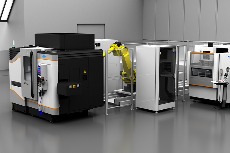

Automation Pallet magazine 5 pallets Delphin
System 3R Workpartner 1+ and Transformer WorkMaster
