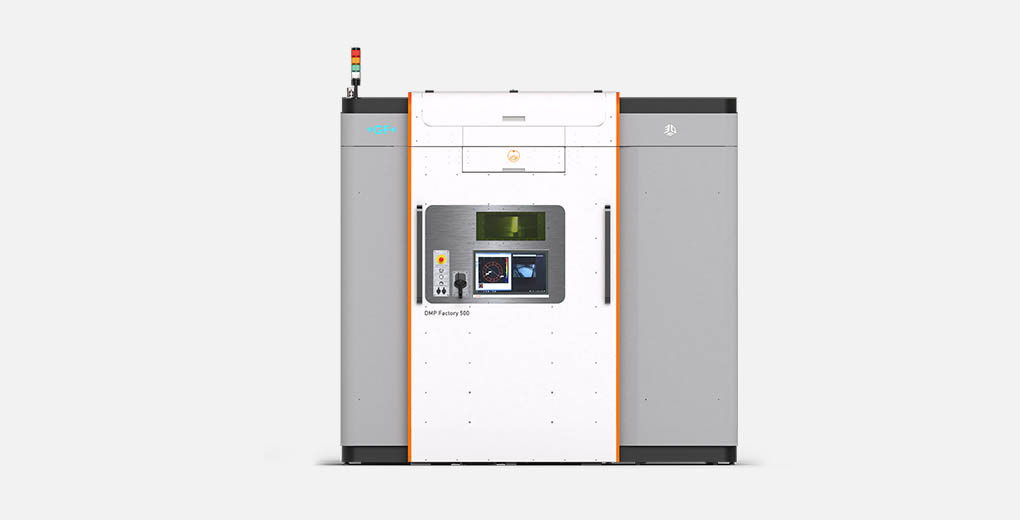

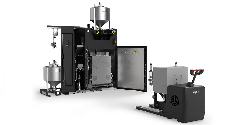

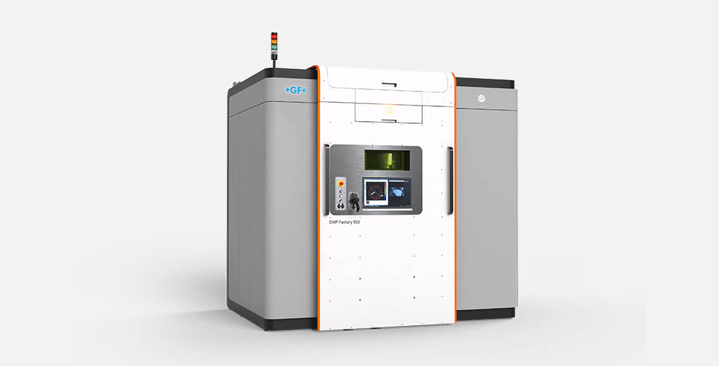

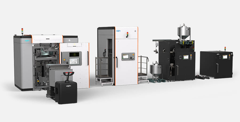

The DMP Factory 500 is a workflow-optimized metal 3D printing solution for massive scalability, repeatable high-quality parts, high throughput and low TCO, producing parts of up to 500 x 500 x 500 mm in size. Engineered using 3D Systems’ proven precision metal additive technology, along with UNITED MACHINING’ technical and industrial knowledge, and the precision SYSTEM 3R clamping systems, the DMP Factory 500 solution is a fully integrated, streamlined metal AM platform.
DPM Factory 500
Main specifications
Main specifications

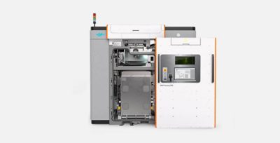

Printer Module uncrated 3010 x 2350 x 3160 mm
Printer Module weight 8232 kg (excluding RPM)

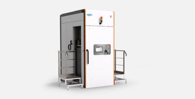

Depowdering Module uncrated 3000 x 2530 x 3300 mm

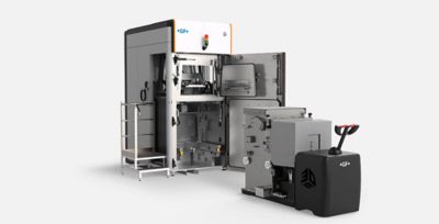

Powder Recycling Module uncrated 1935 x 2262 x 2521 mm
Removable Print Module 1120 x 850 x 1400 mm
Parking Module 1450 x 1780 x 1850 mm
