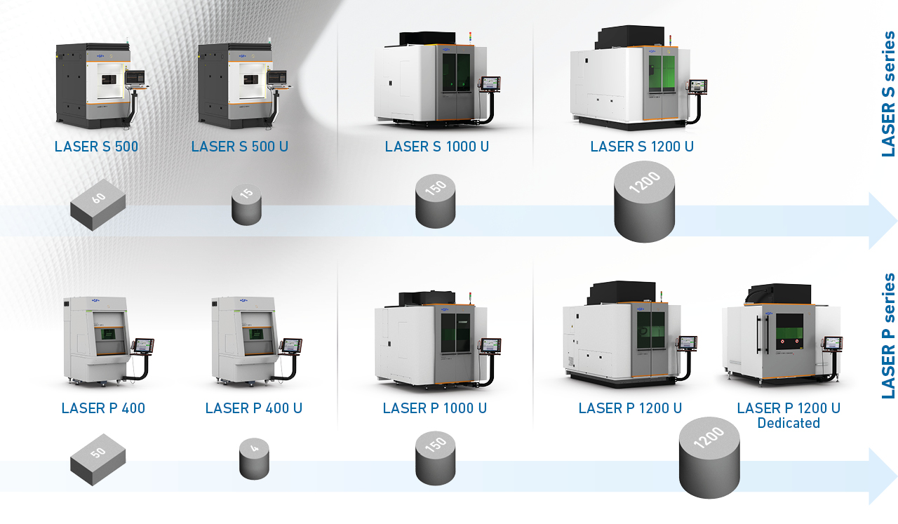

Overview of the series
Our range of Laser machines for Texturing
CHARMILLES LASER S series
A/B or B/C travel
Laser sources
| Machines | XYZ (mm) A/B or B/C travel Laser sources  |
| LASER S 500 | 550 x 400 x 500 - Femto / Nano / Femto + Nano  |
| LASER S 500 (U) | 550 x 400 x 500 B/C: -110/+110°; 0/720° Femto / Nano / Femto + Nano  |
| LASER S 1000 U | 1000 x 550 x 880 180°/720° Femto / Nano / Femto + Nano  |
| LASER S 1200 U | 1200 x 900 x 970 180°/720° Femto / Nano / Femto + Nano  |
| LASER S 2500 U | 2500 x 2000 x 1200 200° (-50/+150), 370° (± 185) Nano  |
CHARMILLES LASER P series
A/B or B/C travel
Laser sources
| LASER P 400 | 600 x 400 x 300 - Femto / Nano / Femto + Nano  |
| LASER P 400 U | 600 x 400 x 300 +115-105°/720° Femto / Nano / Femto + Nano  |
| LASER P 600 U | 600 x 460 x 830 180° / 720° Nano  |
| LASER P 1000 U | 1000 x 550 x 880 180° / 720° Nano  |
| LASER P 1200 U | 1200 x 900 x 1200 180° / 720° Nano  |
| LASER P 1200 U Dedicated | 1200 x 900 x 1200 180°/720° Nano  |
