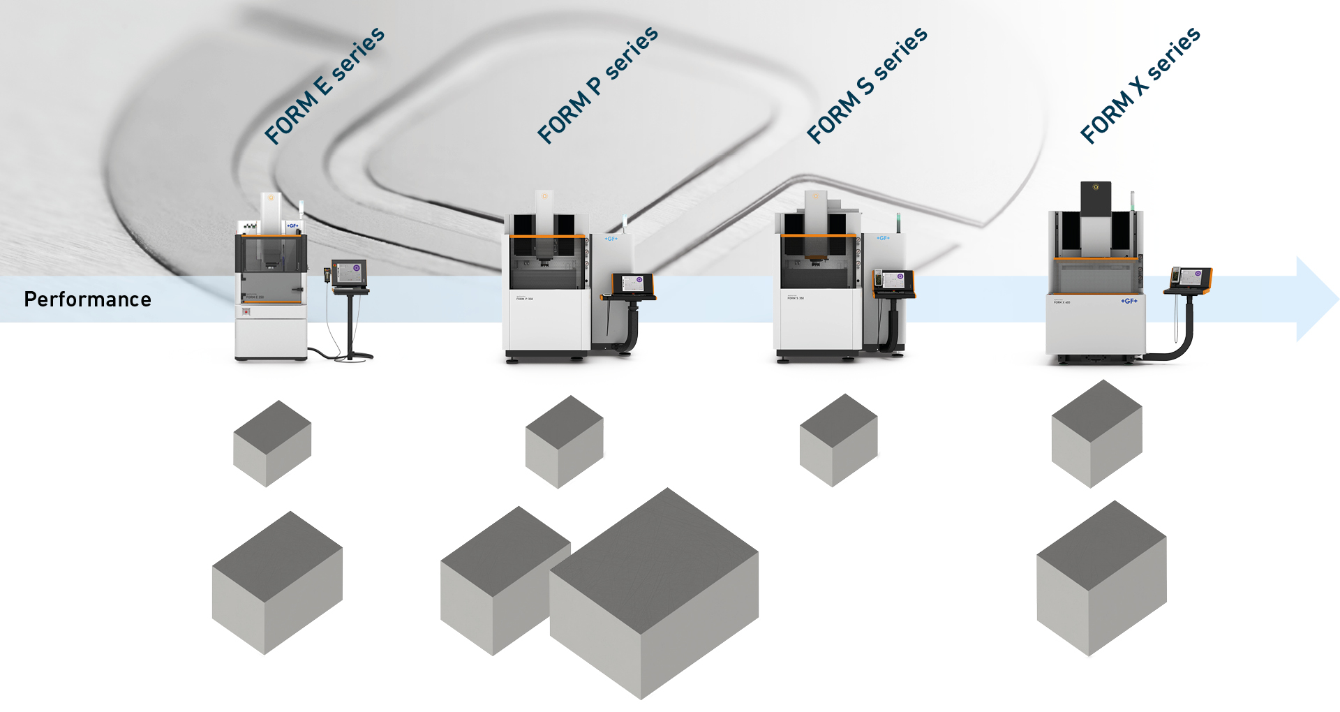

Overview of the series
Our range of die-sinking machines

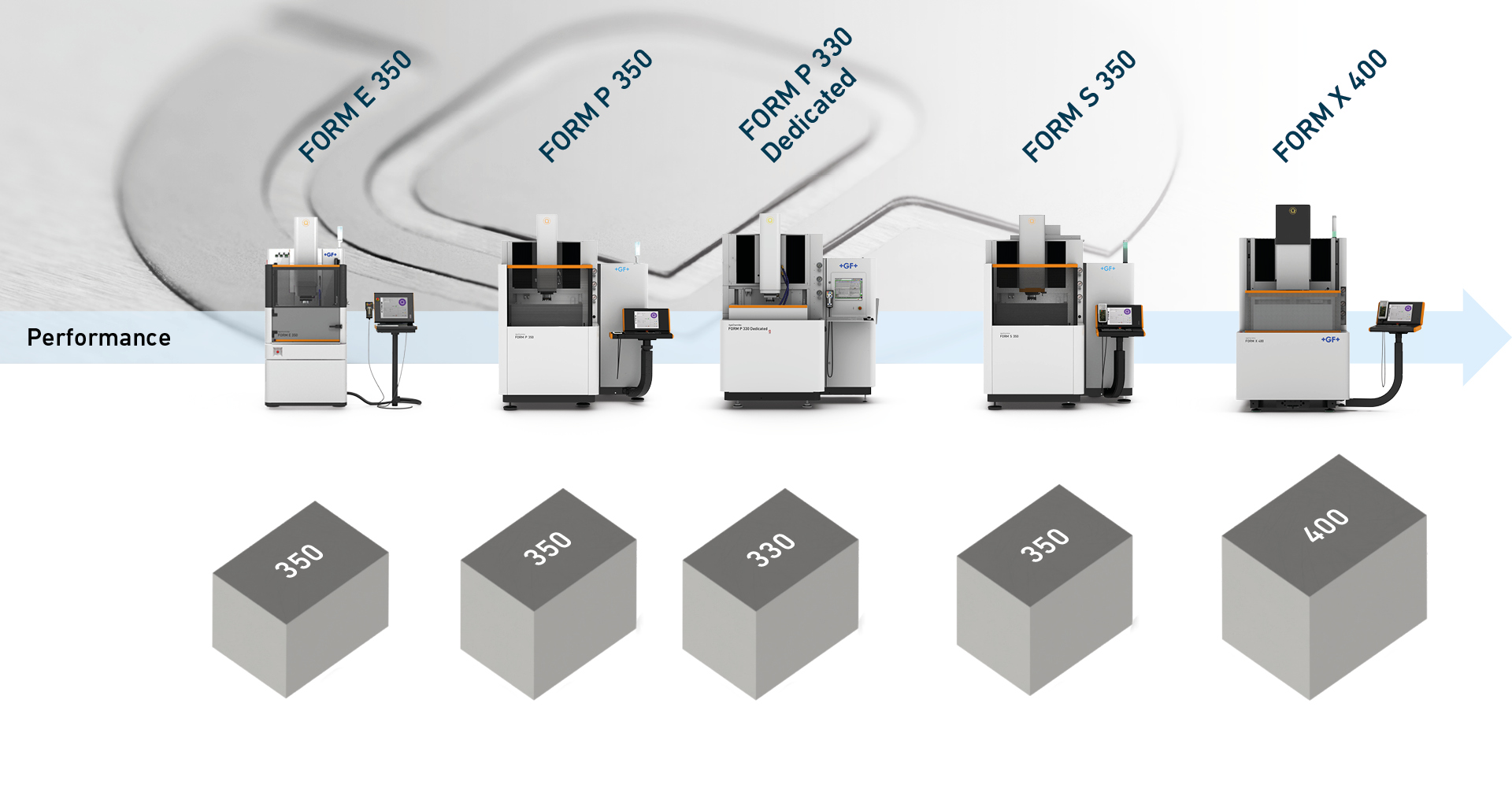

X travel 350-400
| FORM P 330 Dedicated | 350 x 250 x 300 |

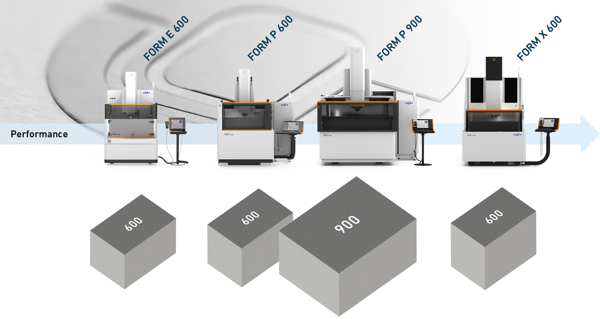

X travel 600-900
