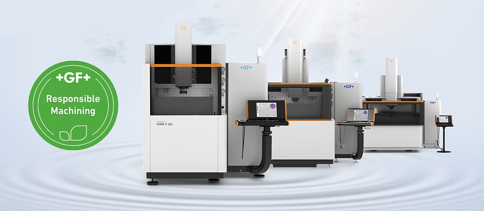

Overview of the series
Our range of die-sinking machines
machine range overview
Overview X travel 350-400 X travel 600-900
X travel 350-400
Machines
Travel XYZ (mm)
Machines Travel XYZ (mm)
FORM E 350 350 x 250 x 250
FORM P 330 Dedicated 350 x 250 x 300
FORM P 350 350 x 250 x 300
FORM S 350 350 x 250 x 300
FORM X 400 400 x 300 x 350
X travel 600-900
Machines
Travel XYZ (mm)
FORM E 600 600 x 400 x 400
FORM P 600 600 x 400 x 450
FORM P 900 900 x 700 x 500
FORM X 600 600 x 400 x 500
