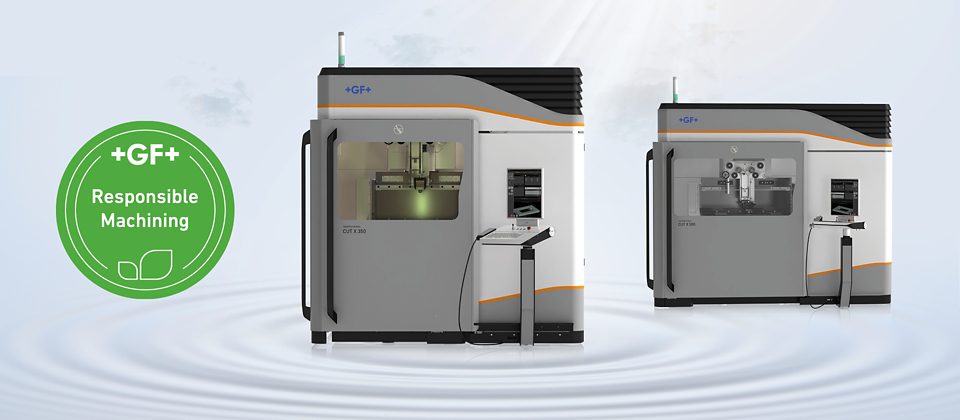

100 years of experience condensed in the best-ever wire EDM machine
          Extreme accuracyOptimized mechanics, new 3D-printed heads design and AI-based thermal management are the basis for unprecedented accuracy and surface quality.
          SimpleIt means easy and flexible for experts as for beginners. Thanks to the collision protection, the wire annealing before threading, a new HMI and the option to change from open to closed guides in only few minutes.
          FastWe cut at unbeatable speed with the Intelligent Power Generator with Direct Power Supply (IPG-DPS) and the unique Twin-wire technology.

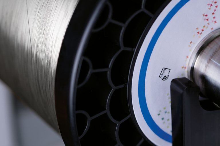

SMART Wire
SMART wire spools are equipped with radio frequency identification (RFID) chips to store wire characteristics and traceability-related data. This feature equips the CUT X and makes it truly a smart solution!
- Improve your production process
- Achieve full traceability
- Share technical issues in an efficient manner
