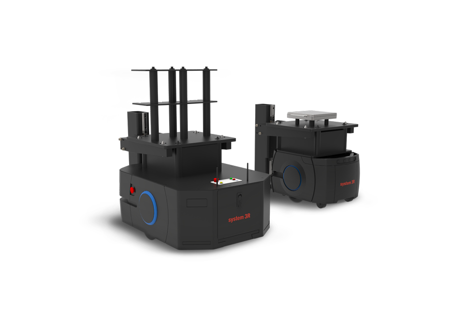

WorkPartner 1+ with EDM machine in integration with AMR unit. AMR with tray and lifter at a loading/unloading station at one of the machine’s sides (where one machining centre only).
WorkPartner 1+ with Milling and EDM machine in integration with AMR unit. AMR with tray and lifter at loading/unloading station that has an automatic door on it’s magazine. There will be an option available on the WPT1+ Light magazine for AMR support to have access to load/unload the tray on the lifter when using one or two machines. The robotarm will move out through the light magazine. The number of tooling positions in the light magazine will be limited, due to this access (support coming beginning 2025).

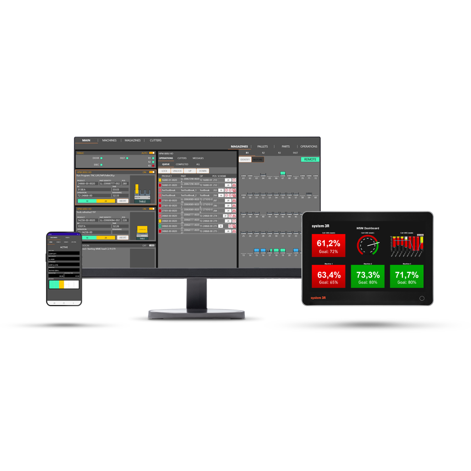

| Cell PC with WSM software | Yes |
