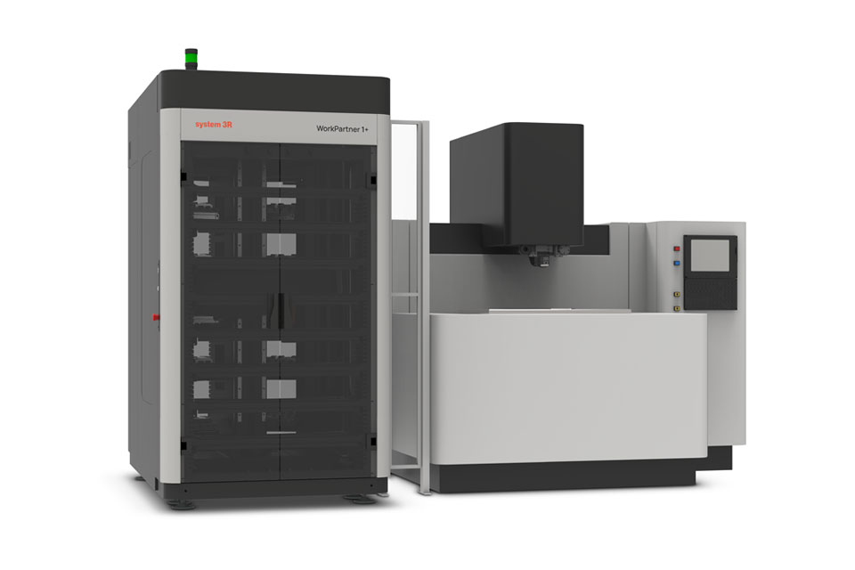

WorkPartner 1+ is intended for applications in milling machines, grinders, die-sinking EDM, wire EDM and laser machines, and it is just as effective with one-off manufacturing as with series production.

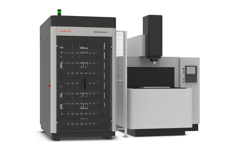

Different applications

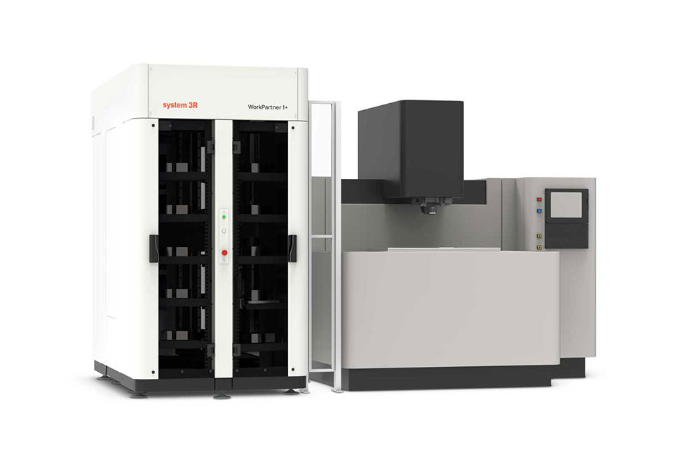

Wire-cutting EDM (wireEDM) application

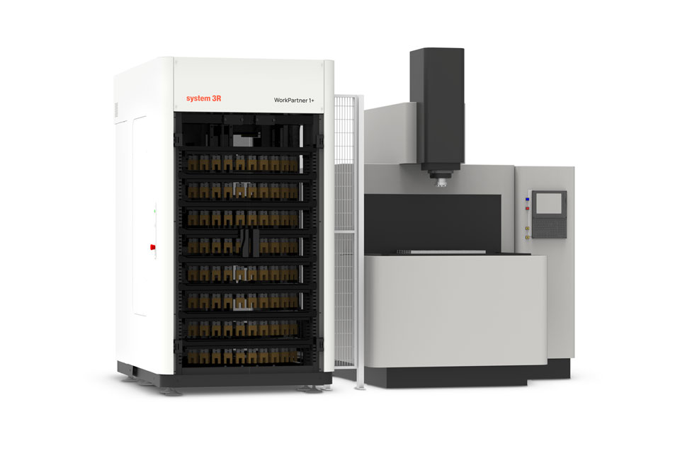

Die-sinking EDM application

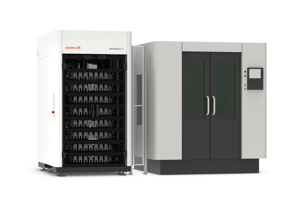

Laser application

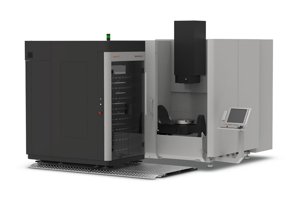

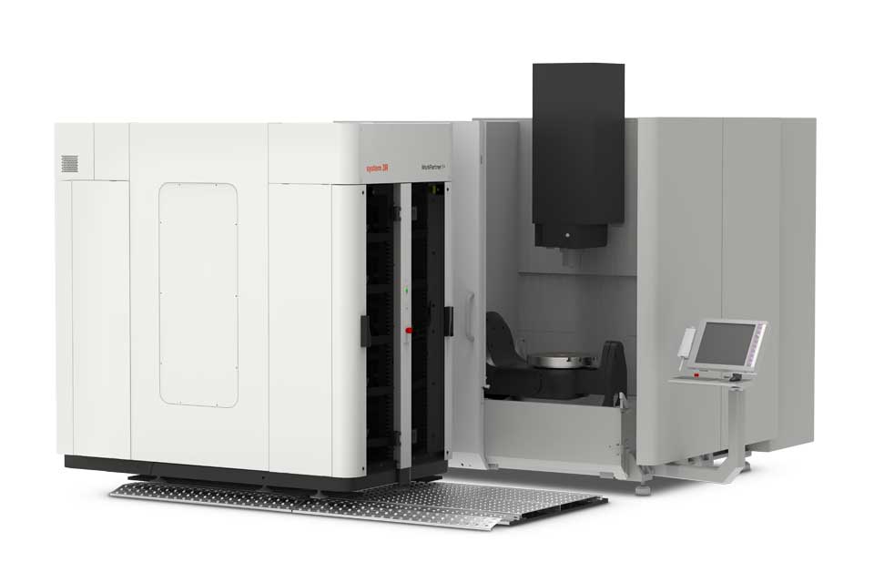

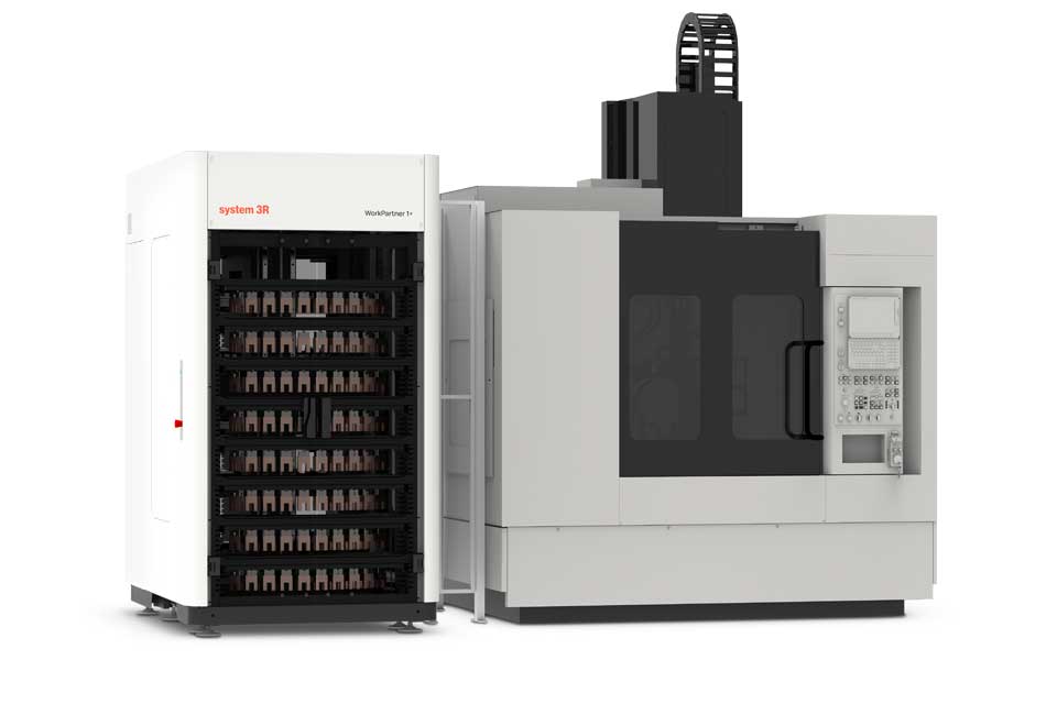

Milling application
Rail application for front loaded milling machines

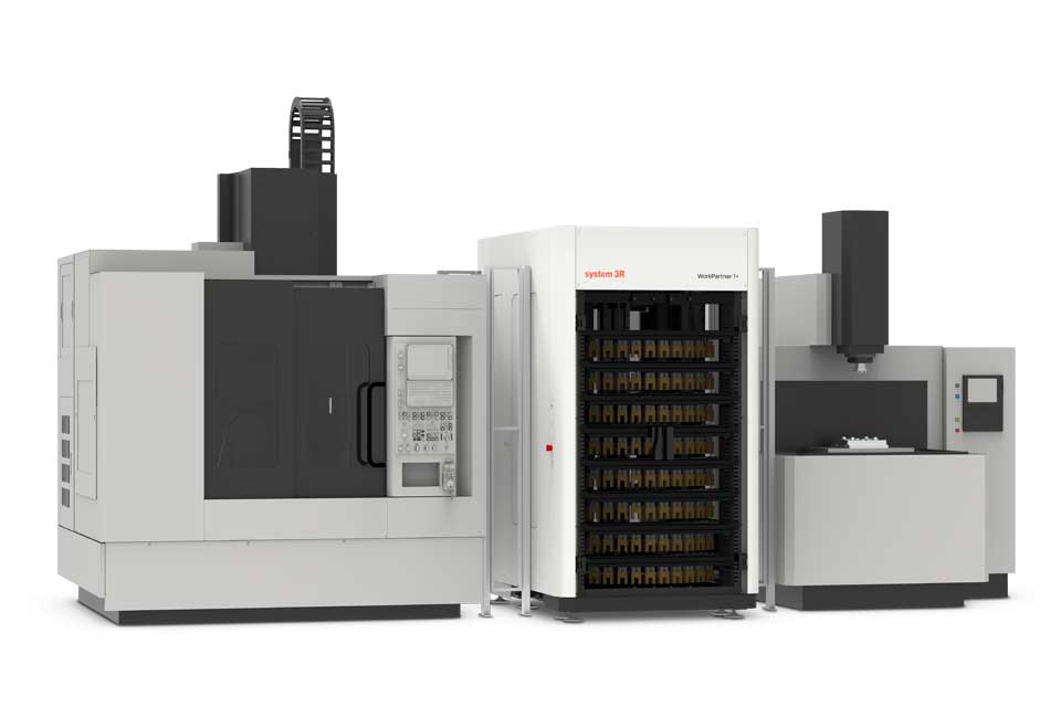

Mixed technologies EDM and Mill

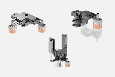

Manipulator unit
Manipulator unit

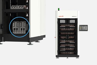

Light magazine
Light magazine
Heavy magazine
Heavy magazine

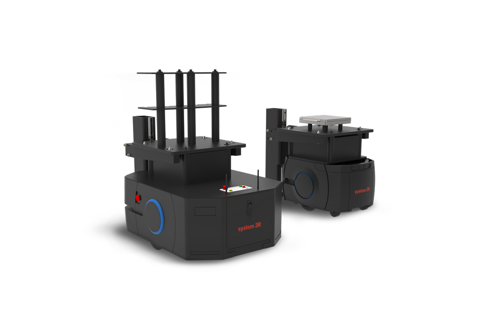

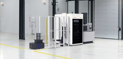

WorkPartner 1+ with AMR integration
AMR and single cell
Single cell
WorkPartner 1+ with EDM machine in integration with AMR unit. AMR with tray and lifter at a loading/unloading station at one of the machine’s sides (where one machining centre only).

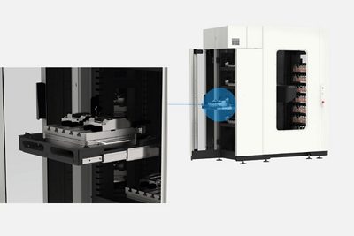

AMR and mixed technologies
Double cell
WorkPartner 1+ with Milling and EDM machine in integration with AMR unit. AMR with tray and lifter at loading/unloading station that has an automatic door on it’s magazine. There will be an option available on the WPT1+ Light magazine for AMR support to have access to load/unload the tray on the lifter when using one or two machines. The robotarm will move out through the light magazine. The number of tooling positions in the light magazine will be limited, due to this access (support coming beginning 2025).

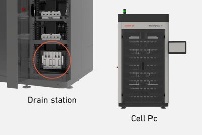

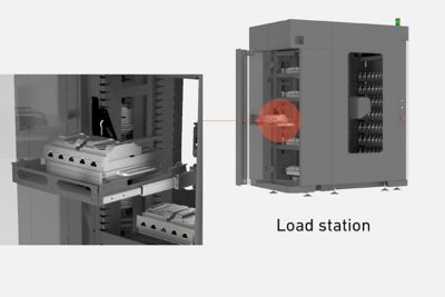

Load station Yes
Drain station Yes
ID-system with or without automatic scanning Yes
Internal magazine lighting (LED) Yes
Cell PC with WSM software Yes
