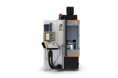

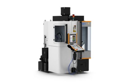

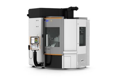

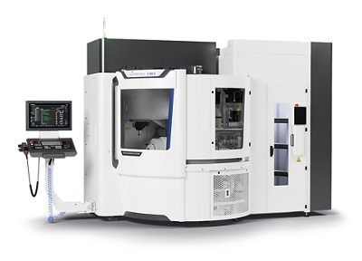

MIKRON MILL X 400 U
The most compact and dynamic milling machine​
Dynamic icon
Dynamic​
Meet complex precision demands with a five-axis system using all-linear direct-drive motors. It offers dynamic response, high acceleration, and precise positioning for faster, vibration-free milling in one setup.
Surface quality icon
Precision and high surface quality​
Robust design with high stiffness and STEP TEC spindle ensures precision and mirror finishes. Linear motors with Ambient Robust tech deliver active thermal stability for consistent accuracy in dynamic applications.​
Machine ergonomics icon
Iconic ergonomics and design​
The MIKRON MILL S/X U series is renowned for ergonomic design and workshop fit. Its optimal setup and accessibility boost ROI with seamless machine-robot integration and scalability.​

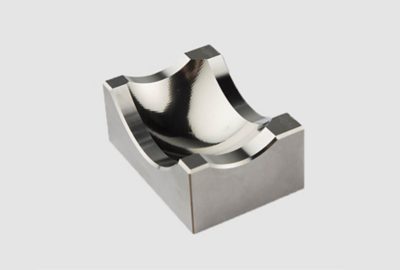

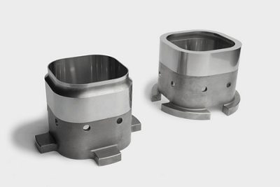

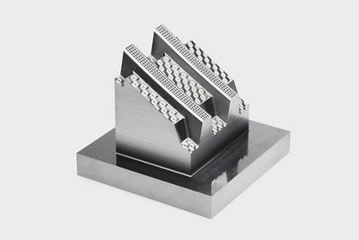

Ideal for automotive reflector mold machining, the MIKRON MILL S and X feature direct linear motors and advanced thermostabilization for precise, stable, and high-quality finishes.​

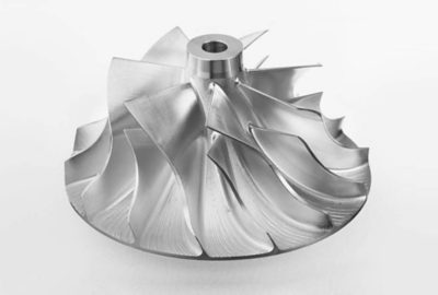

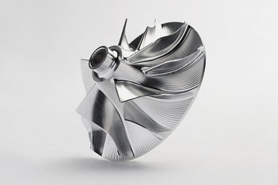

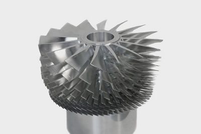

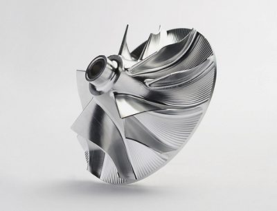

Turbine wheel

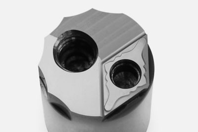

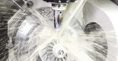

Designed for complex 5-axis machining, the MIKRON MILL S and X excel in applications like impeller, turbocharger, and vacuum compressor manufacturing.​

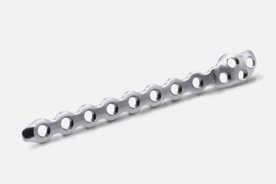

Bone plate

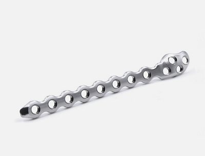

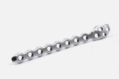

Built for high-dynamic machining, the MIKRON MILL S and X deliver precise results for medical parts like bone saw guides and dental components—offering top performance in a compact footprint​

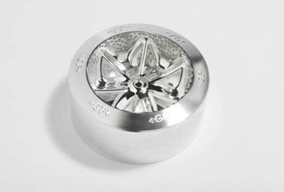

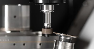

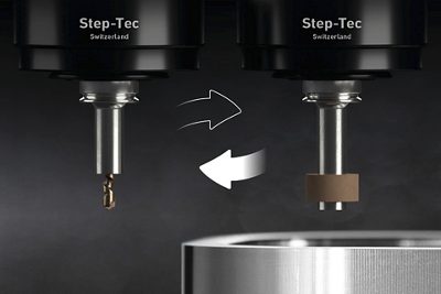

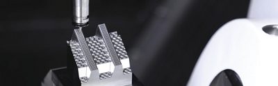

Jig grinding​: Secure and reduce your manufacturing process for optimal surface quality with a single machine​
Two-in-one solution
Two-in-one solution​

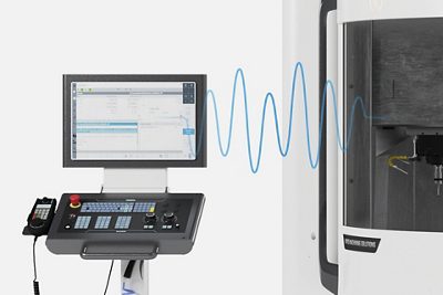

Process monitoring
Monitor your process

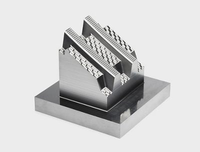

Mold and die dot matrix

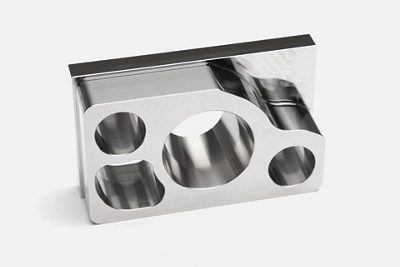

Thanks to the MIKRON MILL S/X U series extend your business opportunity by combining milling and grinding process on the same machine in three- or five-axis simultaneous. Get easily a surface quality of < Ra 0.06 µm.
Grinding process
Stable grinding process​
Mold and die packaging
Maximize your potential​
MIKRON MILL S/X (U) series machines are Automation ready and the grinding option does not impact standard workpiece dimensions or the standard pallet changer. Get automated parts changing to increase your production output while achieving 3 µm machining accuracy and less than 0.06 µm surface roughness.

Boosted numerical control​
The MIKRON MILL S and X series can be equipped with either the Heidenhain TNC 7 or the Siemens Sinumerik ONE control system. Both HMIs are enhanced by an internally developed and patented Smart Machine modules, designed to boost productivity and elevate machining performance to the next level.​

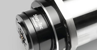

High-quality Swiss made Spindle​
Precision engineered for extreme micromachining
STEP TEC high-speed Spindles use premium components and advanced thermal design for stable, precise, vibration-free micromachining at high speeds. Swiss-made in-house for unmatched quality, ideal for automotive, electronics, and medical applications.

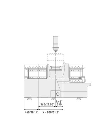

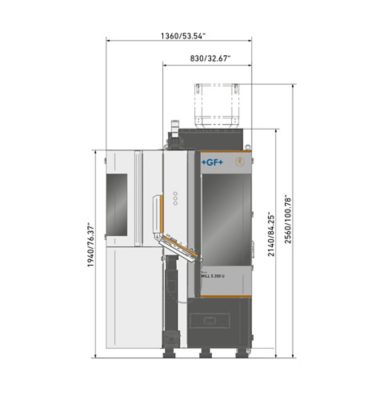

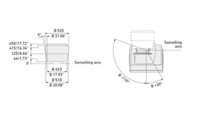

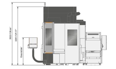

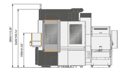

MILL S/X 400 U
Main specifications
Main specifications

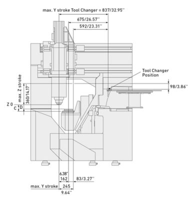

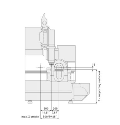

Travel X,Y,Z
500 x 450 x 360 mm
19.68 x 17.72 x 14.17 in

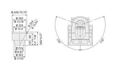

Swiveling range +110°
-110°
Rotary range n x 360°
Rapid traverse X,Y,Z 61 m/min (MILL S)
2,401 in/min
100 m/min (MILL X)
3,937 in/min
Rapid traverse: Swiveling / Rotating 165 / 250 rpm
Pallet/clamping surface MacroMagnum 156
ITS 148
Max. load (incl. pallet) 25 kg
55 lbs
Tool magazine 68/168 (HSK-E40)
Machine weight 7,000 kg
15,432 lbs
Control unit Heidenhain TNC 7​
Siemens SINUMERIK ONE​

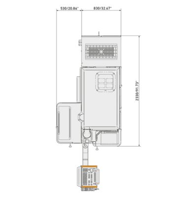

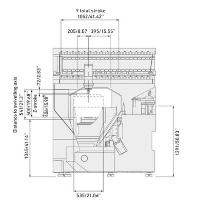

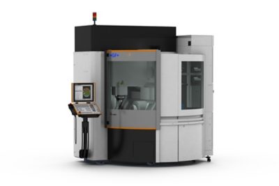

MILL S/X 600 U
Main specifications
Main specifications
Travel X,Y,Z
800 x 600 x 500 mm
31.5 x 23.62 x 19.68 in
Swiveling range +30°
-110°
2,401 in/min
100 m/min (MILL X)
3,937 in/min
Rapid traverse: Swiveling / Rotating 60 / 150 rpm
GPS 240 x 240
UPC 320 x 320
264 lbs
Machine weight 9,900 kg
21,825 lbs
