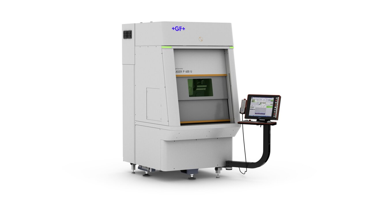

The newest generation of CHARMILLES LASER P series can achieve significant reductions in energy consumption, up to 20% per part. An optimized use of compressed air, additional electrical cabinet cooling and water-cooled refrigeration for Laser sources have made this achievement possible.
Compressed air consumption of the machine is optimized to minimize the flow rate.
Additional thermostats allow activating the electrical cabinet heat exchangers only when needed.
Optional water-cooled refrigeration for Femto lasers sources permit decreasing the machine energy consumption.
Main specifications
Main specifications |
Dimension of complete equipment * |
1227 x 1659 x 2379 mm |
Machine weight (machine only) |
2400 kg |
Floor space (machine only) |
2.04 mq |
Maximum workpiece dimensions 3Ax/5Ax |
600 x 400 x 300 / Ø 120 x h 120 mm |
| Maximum workpiece weight 3Ax/5Ax | 50/4 kg |
| Table size | 680 x 400 mm |
| Travel X/Y/Z | 600 x 400 x 300 mm |
| Rotary 4/5 axis ** | A 115°-105°/B 360° mm |
| Laser sources | Multi-Laser sources: nanosecond and/or ultrashort pulsed laser ** |
| Power consumption | Electrical: 3 x 400 Vac + ground; 6 kVA Pneumatic: 6 bars 500 l/min |
* Width x depth x height ** Option
