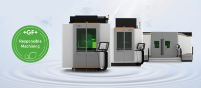

Accelerated productivity with the CHARMILLES LASER S series
Sustainability
The newest generation of CHARMILLES LASER S series can achieve significant reductions in energy consumption, up to 71% per part. The use of a 3D scanner, more powerful laser sources and our SmartPatch and SmartScan software packages have made this impressive achievement possible.

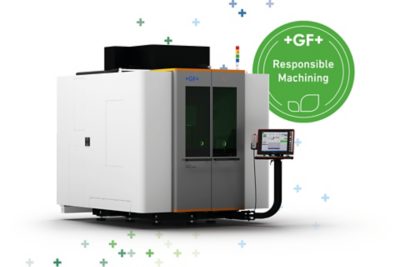

CHARMILLES LASER S 1000 U
Main specifications
Main specifications |
Machine dimensions* |
2240 x 2678 x 2645 mm 88.2 x 105.4 x 104.1 in |
Space required for installation |
3400 x 4000 mm 133.9 x 157.5 in |
Machine weight |
6500 kg 14330 lbs |
Focal length |
FSTC100/FS163/FS255 Type |
Nanosecond pulsed Laser |
50 W Flexipulse/100 W Flexipulse |
Ultrashort pulsed Laser |
20 W Femto Flexipulse Infrared FD 100 W Femto IR FD |
Electrical and pneumatic supply
Electrical and pneumatic supply |
Nominal power |
8 kVA |
Air pressure |
6 bar |
Required air output flow |
300 l/min |
Printing specifications
Printing specifications |
X, Y, Z travels |
1000 x 550 x 880 mm 39.4 x 21.7 x 34.6 in |
Travel Laser head: A |
180 ° |
Travel machine table: B |
720 ° |
Table dimensions |
380 mm 15 in |
Distance floor to table |
925 mm 36.4 in |
Working area
Working area |
Max workpiece dimensions |
Ø 660 ** mm Ø 26 ** in |
Max workpiece machining height |
550 ** mm 21.7 ** in |
Max workpiece weight five axis |
150 kg 330 lbs |
Full five-axis dimensions |
Ø 510 x 480 ** mm Ø 20 x 18.9 ** in |
* Width x depth x height ** with FS163 *** with FS255 **** with FS340
