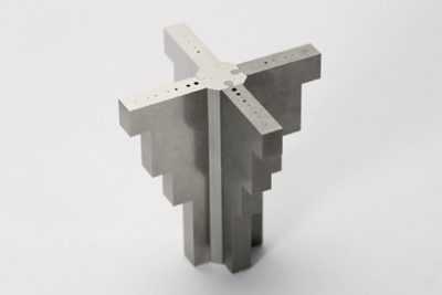

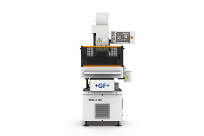

AGIE CHARMILLES DRILL E 300 is a high-speed drill machine widely used for drilling starting holes. In aerospace for aircraft engines, as well as gas turbines in energy production, cooling holes are needed for creating a film of cooling air on the surface of turbine blades and vanes to prevent them from overheating. The DRILL E 300 is the perfect solution when you need to add small holes on a part with inclined faces or hard-to-reach positions.
DRILL E 300
DRILL E 300
Maximum drilling depth 200 mm
7.78 in
660 lb
11.8 x 7.8 x 11.8 in
15.7 x 11.8 in
Rotating spindle 57.5 rpm
3.9 in
Heavy duty generator 30 A
Dielectric volume 16 l
4.2 us gal
Mains connections 3 x 400 V
50/60 Hz
52.9 x 37 x 80.3 in
1918 lbs
