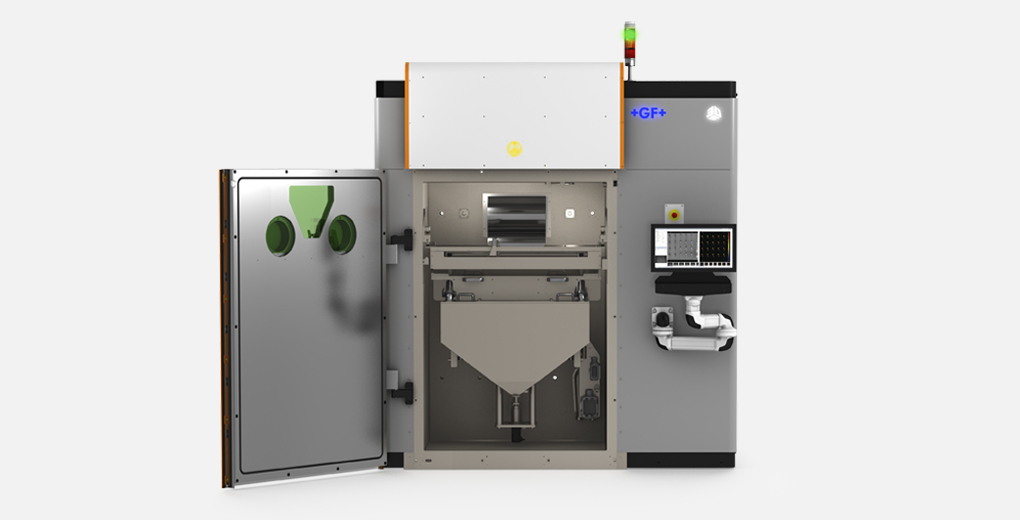

- DMP Flex 350 front
 - AM process
 - DMP Flex 350 front open
 - 3DXpert® software
 - DMP Flex 350 side
 - Hip cups
 - DMP Flex 350 side open

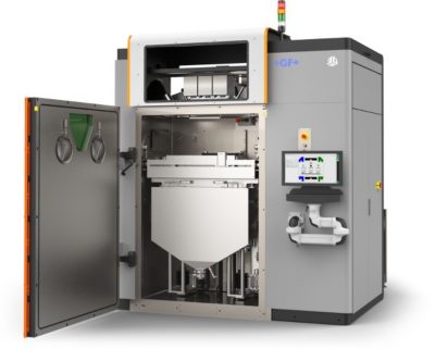

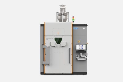

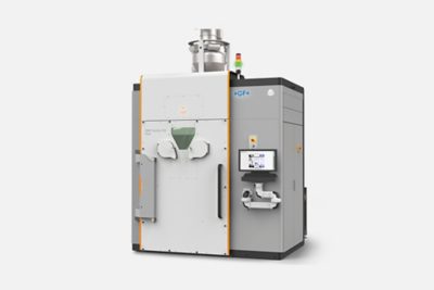

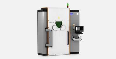

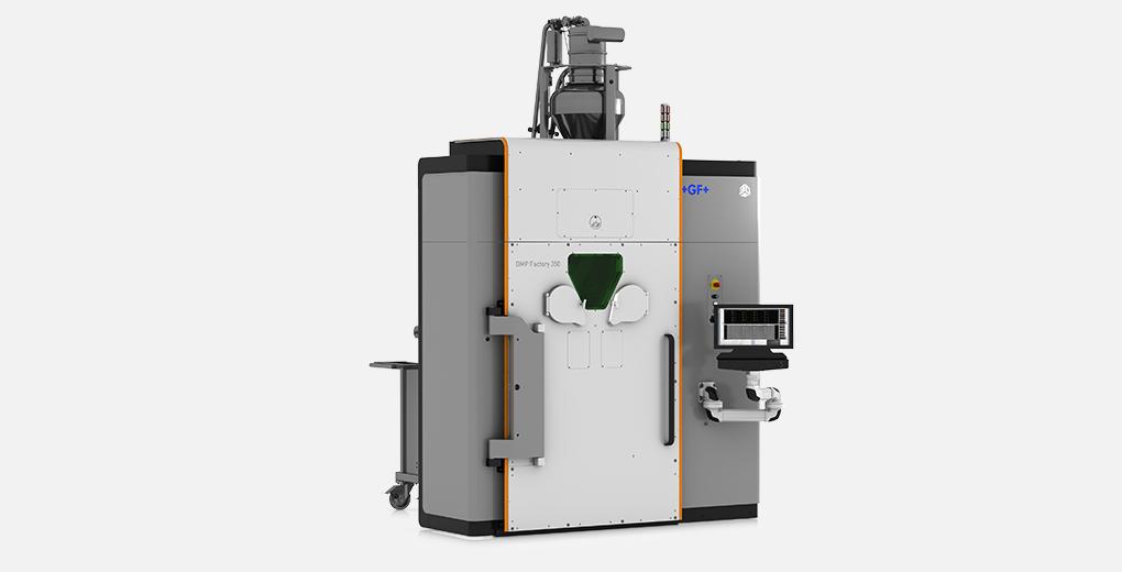

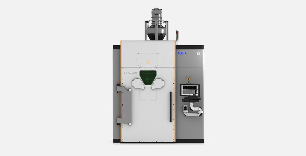

DMP Factory 350
Ensure maximum safety and powder integrity

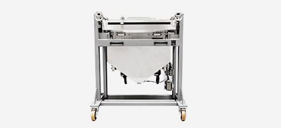

DMP Factory 350 has an integrated powder management system with high-performance sieving and automated powder conveyance. The O2-free atmosphere of the powder workflow guarantees highest part quality as well as maximum powder usage and minimizes user powder contact.
- DMP Factory 350 front
 - DMP Factory 350 side

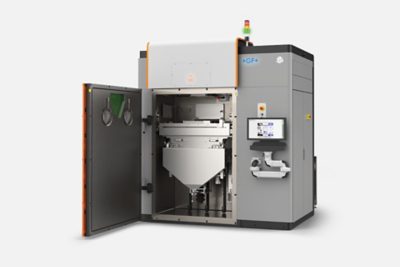

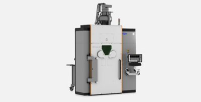

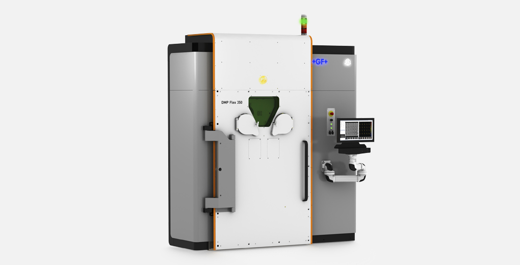

DMP Flex/Factory 350 features
Unique vacuum chamber concept
Consistent, low O2 environment

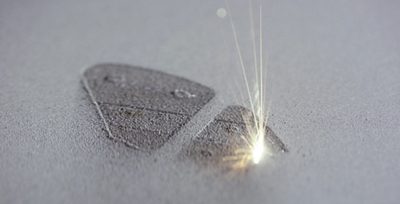

Reduce your cost to part by avoiding non-quality scrap issues and get access to higher-margin regulated markets like aerospace and medical, where constant quality is a requirement for certified parts. Discover these benefits, thanks to our consistently low 02 environment in the printer to guarantee consistent powder quality for high-quality parts.

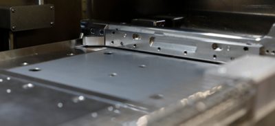

Bi-directional recoating
Boost your productivity
Accelerate your productivity to reduce your cost per part, thanks to our high-performance, bidirectional recoating system that consistently and accurately deposits a fresh powder layer on each pass to reduce the time that the lasers are active.

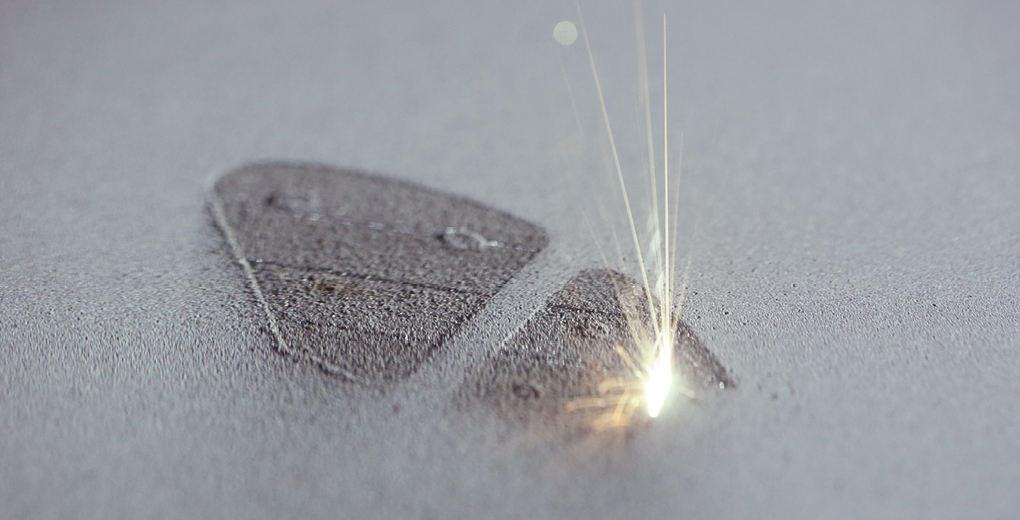

DMP Monitoring
Real-time process monitoring
DMP Monitoring allows users to see, analyze, understand and fine-tune their metal AM process with unprecedented capability. The DMP Monitoring toolset for enhanced quality control includes real-time process monitoring, synchronized images of the melt pool and powder bed, synchronized images of active and archived jobs for comparison, and a toolset for analyzing the magnitude of a subject area, enabling:
- Real-time, in-build data collection and visualization
 - Post-build process analysis
 - Build parameter optimization

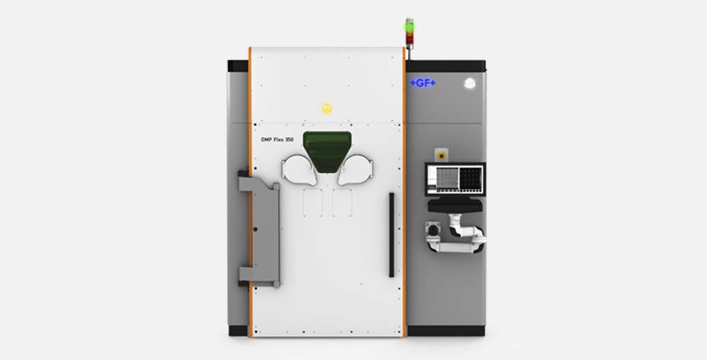

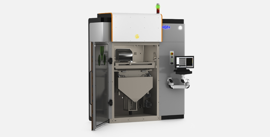

DMP Flex 350 features
Removable print module
Increase your flexibility
Improve your flexibility and productivity with a Removable Print Module (RPM) that can be replaced with another RPM just after a job is finished. This also positively impacts the total cost of ownership because you can reduce downtime when switching from one material to another material by having one dedicated RPM per material.

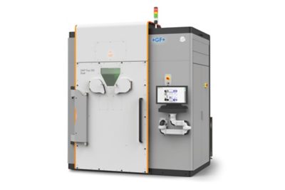

DMP Flex/Factory 350 Dual
The DMP Flex 350 and DMP Factory 350 systems now come in a two-laser configuration, reducing build times by up to 50 percent. Boosting productivity while maintaining high quality and repeatability yields lower operational costs.
New features
New Dual Laser (2x 500 W) configuration
Increases productivity and reduces costs
New pre-filter cyclone system
Decreases filter costs
New heated platform
Reduces risk cracking of specific building jobs
Enhanced Removable Print Module
Enables easy, fast and consistent calibration
Enhanced coater accuracy
Decreases machine-to-machine variability
Enhanced coater cutting tool
Decreases operator errors and machine-to-machine variability
New back powder tray on exhaust
Reduces loss of powder during cleaning
New Railroad UI in Operator mode
Reduced operator error

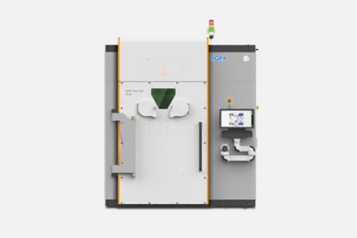

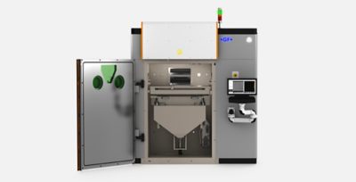

- DMP Flex 350 Dual front
 - DMP Flex 350 Dual side
 - DMP Factory 350 Dual front
 - DMP Factory 350 Dual side
