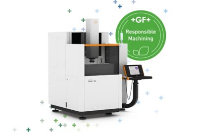

Sustainability
Discover our innovations that allow our new Die-sinking EDM machines to achieve reductions of up to 43% in daily energy consumption, compared to the previous generation.

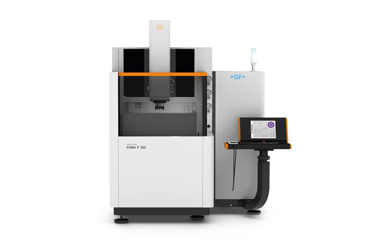

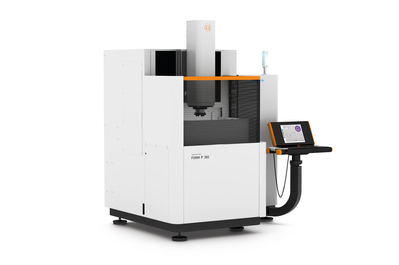

FORM P 350
Machine dimensions *
1900 x 1690 x 2398 mm
74.80 x 66.53 x 94.4 in
Total weight (without dielectric)
2800 kg
6173 lbs
Travel X, Y, Z *
350 x 250 x 300 mm
13.78 x 9.84 x 11.81 in
Min./Max. distance between table and chuck ***
150-450 mm
5.91-17.72 in
Best surface finish RA 0.08 μm
Capacity
410 l
108.65 gal
Workpiece and electrode
Max. workpiece dimensions *
700 x 460 x 285 mm
27.56 x 18.11 x 11.22 in
Max. workpiece weight
500 kg
1102.31 lbs
Max. electrode weight
50 kg
110.23 lbs
Bath level (programmable)
100 - 305 mm
3.94 - 12.01 in
* Width x depth x height ** Width x depth *** With C-Axis Eco + SYSTEM 3R Macro

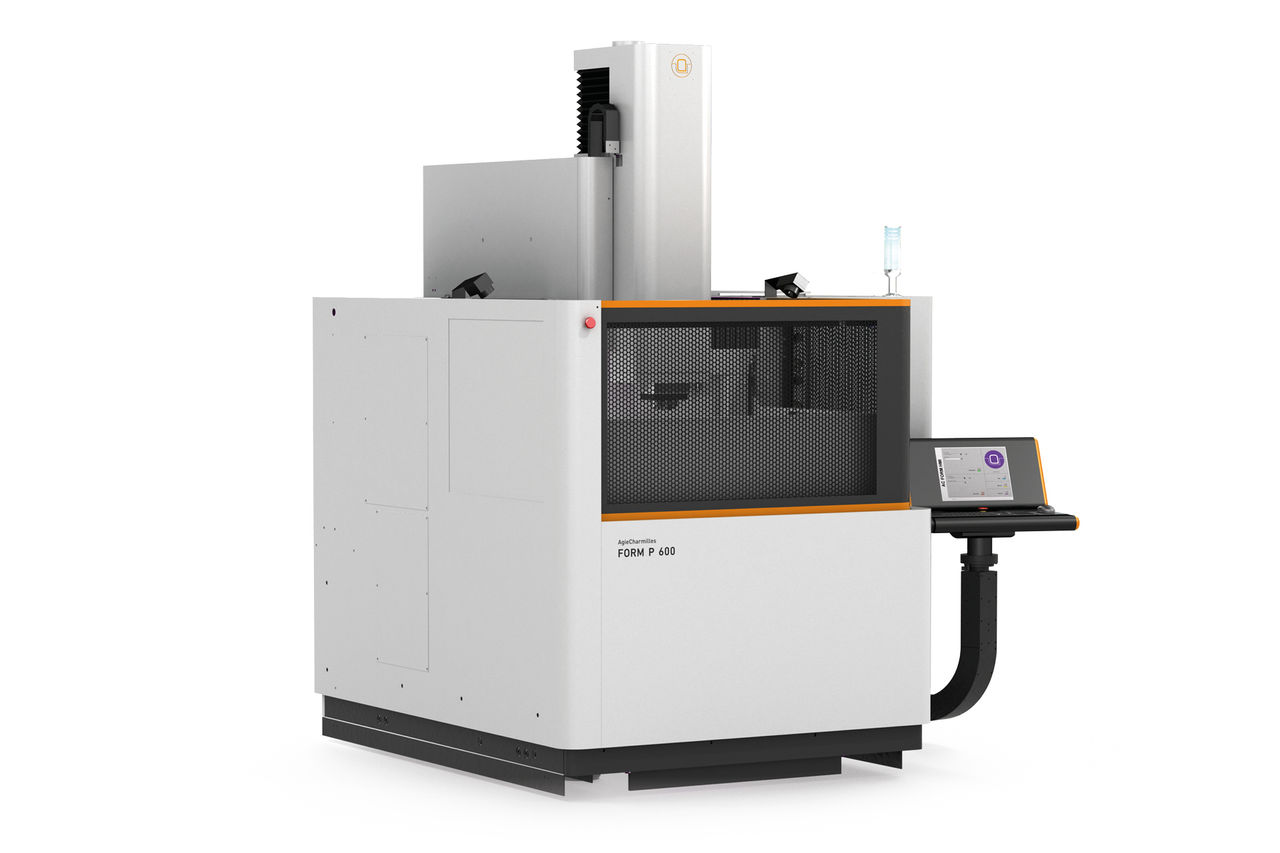

FORM P 600
2265 x 2110 x 2780 mm
89.17 x 83.07 x 109.45 in
4500 kg
9920 lbs
Travel X, Y, Z *
600 x 400 x 450 mm
23.62 x 15.75 x 17.72 in
150-600 mm
5.91-23.62 in
Capacity
700 l
184.8 gal
1040 x 730 x 410 mm
40.94 x 28.74 x 16.14 in
1600 kg
3527.40 lbs
50 kg
110.23 lbs
100 - 400 mm
3.94 - 15.75 in

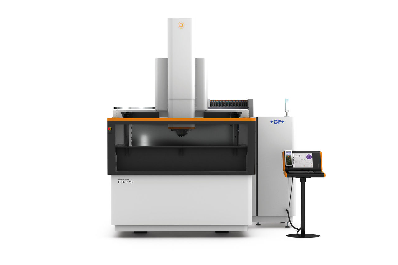

FORM P 900
2970 x 3100 x 3320 mm
116.93 x 122.05 x 130.71 in
7000 kg
15432 lbs
Travel X, Y, Z *
900 x 700 x 500 mm
35.43 x 27.56 x 19.68 in
322-822 mm
12.68-32.36 in
Best surface finish RA 0.1 μm
Capacity
2500 l
662.5 gal
1670 x 1120 x 560 mm
65.75 x 40.09 x 22.05 in
3000 kg
6613.86 lbs
50 kg
110.23 lbs
100 - 500 mm
3.94 - 21.65 in
