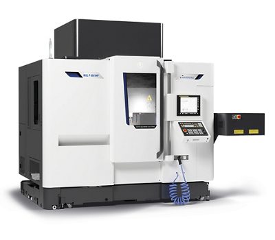

MIKRON MILL P 500 VHP
Precision in every detail, accuracy in every move​
Outstanding micromachining performances over long cycle time

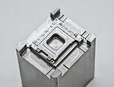

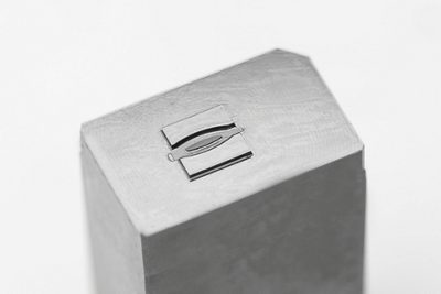

Application
Delivers micron-level precision and thermal stability for compact ICT components. Perfect for reliable, high-volume part manufacturing.

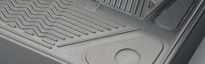

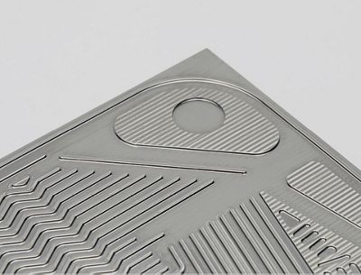

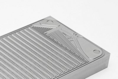

Bipolar plate
Enables precise, high-speed machining of fuel cell plates. Ensures accuracy and repeatability for automotive needs.

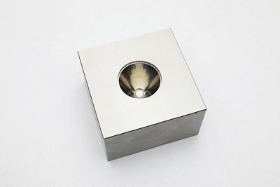

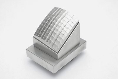

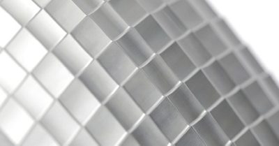

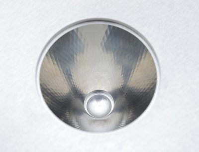

Reflector mold
Delivers ultra-smooth surface finishes with stable, high-precision machining. Perfect for reflector molds requiring optical-grade quality.

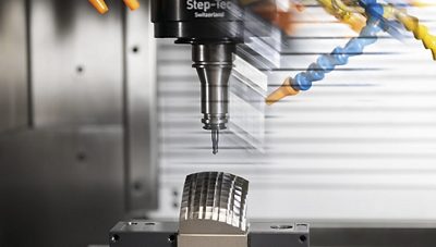

High-quality Swiss made Spindle​
Precision engineered for extreme micromachining
STEP TEC high-speed Spindles use premium components and advanced thermal design for stable, precise, vibration-free micromachining at high speeds. Swiss-made in-house for unmatched quality, ideal for automotive, electronics, and medical applications.

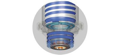

OptiCool design
OptiCool​
STEP TEC’s OptiCool Spindle series ensures not only that the Spindle remains thermally stable, but that natural heat transfer to the Spindle support (e.g., Z axis) is limited to the lowest amount possible, in order to preserve the machine’s geometry.​
CoolCore design
CoolCore​
Where conventional stator cooling reaches its limits, STEP TEC’s CoolCore Spindle goes beyond the ordinary to lower the temperature and minimize temperature fluctuations in the rotating shaft.​
