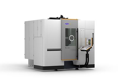

Agility for the future: MIKRON MILL P series delivers intelligent productivity to help mold and die manufacturers overcome their challenges. Rapid market developments and future-changing innovations challenge mold and die manufacturers’ ability to adapt to change. MIKRON MILL provides these manufacturers with agility for the future with its MIKRON MILL P series of five-axis, simultaneous Milling machines.The MIKRON MILL P U Series is a very robust, stable and accurate machine center in a gantry-type design. This five-axis Milling solution is designed for high-performance machining applications. For best accuracy and surface finish by simultaneous operation, the machine has water-cooled direct drives in the rotary and swiveling axes. These axes can be clamped to reach even a higher stiffness during roughing. Workpiece access is made easy by the big door and the short distance to the work table. Thanks to its unique concept and its modularity, the machine ensures precise machining applications in both single item and fast, productive serial production.

MILL P 500 U
Travel X, Y, Z 500 x 600 x 450 mm
Feed rate X/Y/Z 45 (61 dynamic version) m/min
Swivelling range +91/-121°
Rotary range n x 360 rpm
Feed rate swivel 25 (50 dynamic version) rpm
Feed rate rotary 35 (60 dynamic version) rpm
Working table T-slot table Ø500
System 3R Dynafix / Delphin / Erowa UPC
Table load 200 / 600 kg
Tool magazine 30 / 60 / Tool Tower 120 / 170 / 215 pockets

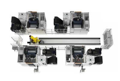

Automation Pallet magazine 7 Dynafix / UPC
Pallet magazine 5 Delphin

Automation Pallet magazine 7x (500x630)
Pallet magazine 9x (500x500)
Pallet magazine 12x (400x400)

Automation Pallet magazine 7x (Ø730)
Pallet magazine 9x (Ø500)
Others on request

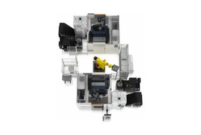

Automation System 3R Transformer 6-axis
