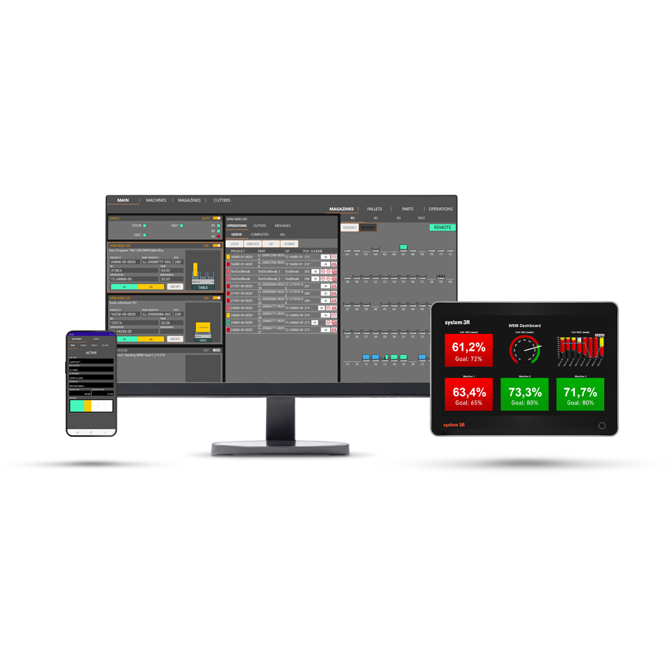

| Cell PC with WorkShopManager software | |
