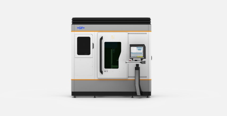

- ML-5 - vue face avant

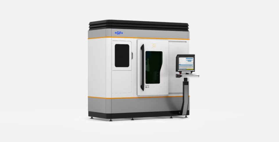

- ML-5 - vue latérale

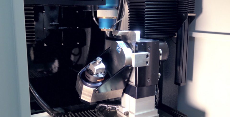

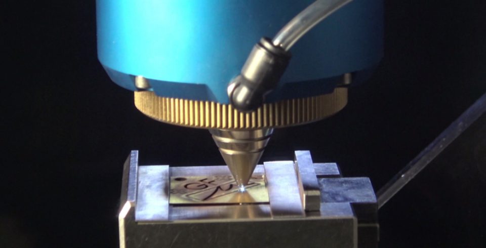

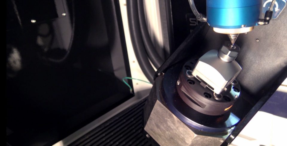

- Configuration cinq axes 1
- Configuration cinq axes 2

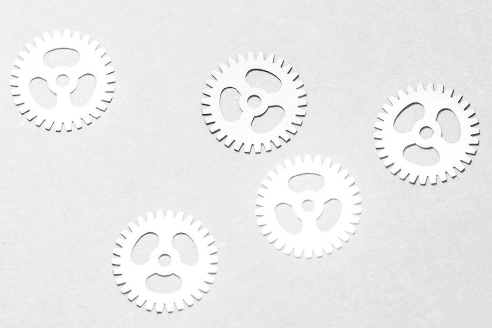

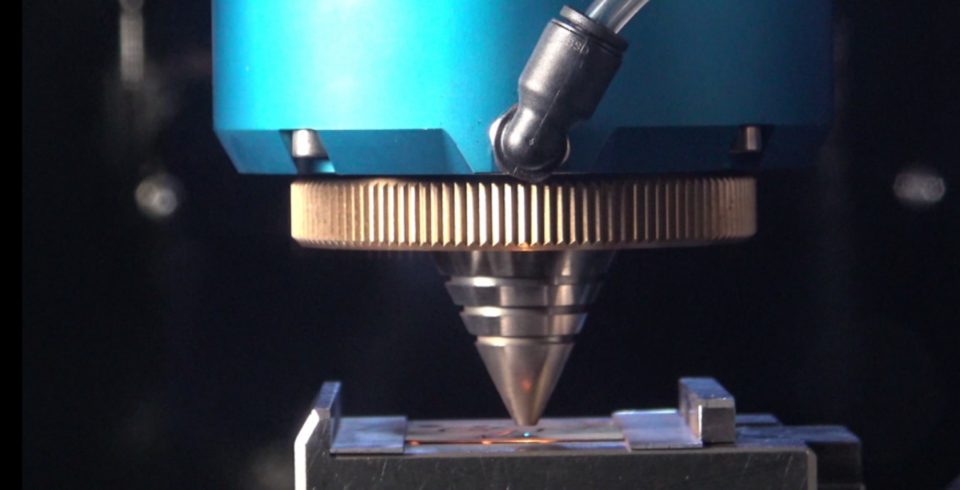

- Découpe au laser femtoseconde
- Découpe droite des parois latérales

ML-5
Machine
Machine |
Machine dimensions* |
2010 x 2450 x 2720 mm 79.1 x 96.5 x 107.2 in |
Machine weight |
2730 kg 6019 lbs |
Yb: KGW (Diode-pumped) |
40/80 W |
Accessory cabinet dimensions * |
1000 x 1200 x 1580 mm 39.5 x 47.1 x 62.2 in |
Electrical and Pneumatic supply
Electrical and Pneumatic supply |
Nominal power |
7.2 kVA |
Air pressure |
7 bar 0.68 MPa |
Required air output flow |
280 l/min 74.8 gal/min |
Axes
Axes |
X, Y, Z travels (3-axis) |
280 x 350 x 260 mm 11.02 x 13.78 x 10.24 in |
X, Y, Z travels (5-axis) |
120 x 350 x 260 mm 4.72 x 13.78 x 10.24 in |
A (tilt) travel |
+95° to -125° |
| C (rotary) travel | 360° (continuous) |
* Width x length x height
