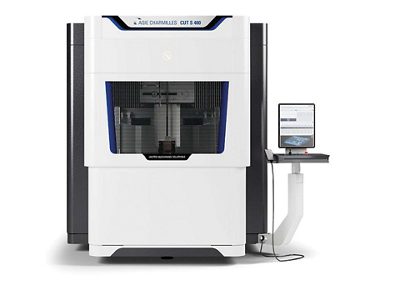

AGIE CHARMILLES CUT S Series
Designed for superior precision. Built for productivity
Superior precision redefined
Achieve unparalleled accuracy and efficiency with our new, standard-setting, superior precision CUT S 400/600/800 wire-cutting Electrical Discharge Machining (EDM) series. These machines are designed to deliver exceptional performance, reduce operational costs, and enhance productivity in high-precision manufacturing.

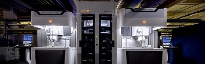

Ready to automate
Right out of the box, you’re ready for automation due to our symmetrical TETRAX mechanical design allowing two-sided access to the table and left or right configurability for maintenance-related accessibility. Compactness optimizes the machine’s footprint.

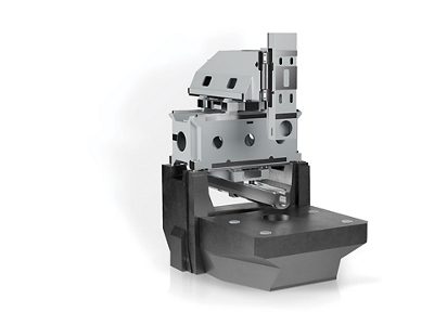

Advance design, strong performance
New TETRAX frame design: precision without limits
Unlock full machining potential with unlimited taper, full Z-axis travel, and micron-level precision. TETRAX redefines automation, flexibility, and accessibility. Master complexity. Eliminate limits.

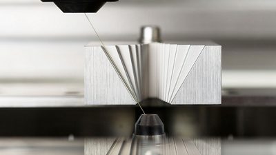

Taper machining without limits
Infinite taper machining – unrestricted angles, unlimited possibilities
TETRAX unlocks full-axis freedom - eliminating taper and height limits. With 600+ technologies and closed diamond wire guides, it delivers unmatched precision, smooth threading or rethreading and reliability

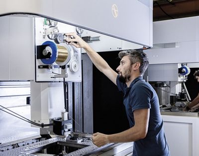

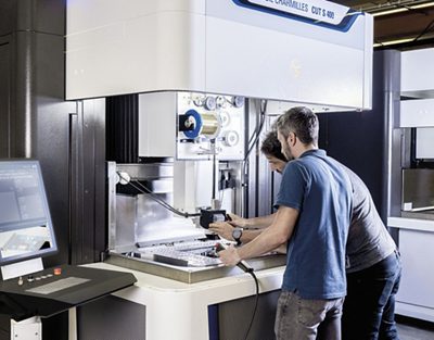

Fast-track wire setup - right where you need it.
Fast front-end installation, large 25 kg spools option for extended autonomy, and RFID-enabled Smart Wire for automatic recognition and traceability. Less downtime, smoother workflow, and more time machining.

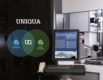

UNIQUA - fast, intuitive, human-centered control
Program with ease using ISO or dynamic UNIQUA modes. Cut precisely with Dynamic Corner Control, reducing post-processing. EDM-EXPERT optimizes settings automatically for any material, boosting uptime and confidence

Ready to automate
Greater versatility from the start
Automation begins with TETRAX: a compact, symmetrical design enabling two-sided access and full automation from day one.
OPC UA connectivity ensures seamless smart factory integration. Key features - Automatic Slug Welding, Wire Threading, and integrated wire chopper - eliminate manual tasks, minimize downtime, and boost precision-driven productivity.
