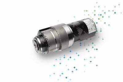

Step-Tec HVC 120 - Micromill
Dimensions / weight
ø120 x 402 mm / 19 kg
| Dimensions / weight | ø120 x 402 mm / 19 kg |
| Speed (nmax) | 75’000 rpm |
| Torque S1 / S6 40% | 1.5 / 1.7 Nm |
| Power S1 / S6 40% | 10 / 13.5 kW |
| Interfaces | HSK E 25 |
| Through Spindle Coolant | O, H2O, oil, MQL |
| Lubrification | oil-air |
Step-Tec HVC 120 - Preciprod
Dimensions / weight
ø120 x 429 mm / 22 kg
| Dimensions / weight | ø120 x 429 mm / 22 kg |
| Speed (nmax) | 60’000 rpm |
| Torque S1 / S6 40% | 2.7 / 3.5 Nm |
| Power S1 / S6 40% | 6.5 / 8.5 kW |
| Interfaces | HSK E 32 |
