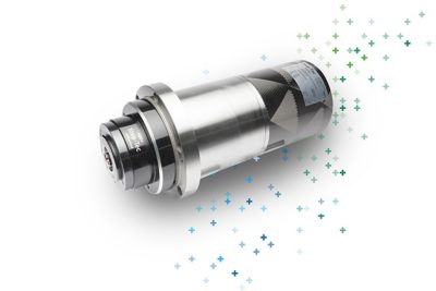

Step-Tec HVC/HPC 150 - One Touch
Dimensions / weight
ø150 x 579 mm / 55 kg
| Dimensions / weight | ø150 x 579 mm / 55 kg |
| Speed (nmax) | 24’000 rpm |
| Torque S1 / S6 40% | 31 / 41 Nm |
| Power S1 / S6 40% | 23 / 30 kW |
| Interfaces | HSK A/C/ 63, HSK F 80 |
| Through Spindle Coolant | O, H2O, oil, MQL |
| Lubrification | oil-air |
| Cooling | OptiCool, Option: CoolCore (Shaft cooling) |
Step-Tec HVC/HPC 150 - Tool Maker
Dimensions / weight
ø150 x 468 mm / 40 kg
| Dimensions / weight | ø150 x 468 mm / 40 kg |
| Speed (nmax) | 36’000 rpm |
| Torque S1 / S6 40% | 16 / 21 Nm |
| Power S1 / S6 40% | 25 / 33 kW |
| Interfaces | HSK C/E 50, HSK F 63 |
