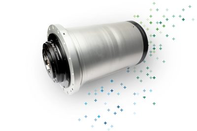

Step-Tec HPC 290 - Toughprod
Dimensions / weight
ø290 x 834 mm / 290 kg
| Dimensions / weight | ø290 x 834 mm / 290 kg |
| Speed (nmax) | 10’000 rpm |
| Torque S1 / S6 40% | 512 / 702 Nm |
| Power S1 / S6 40% | 66 / 89 kW |
| Interfaces | SK 50, HSK A/T 100 |
| Through Spindle Coolant | O, H2O, oil, MQL |
| Lubrification | oil-air / grease |
| Cooling | OptiCool, Option: CoolCore (Shaft cooling) |
| Mill-Turn function | Interlock (SSL) 800 Nm |
Step-Tec HPC 290 - Tool Maker
Dimensions / weight
ø290 x 665 mm / 233 kg
| Dimensions / weight | ø290 x 665 mm / 233 kg |
| Speed (nmax) | 15’000 rpm |
| Torque S1 / S6 40% | 279 / 366 Nm |
| Power S1 / S6 40% | 35 / 46 kW |
| Interfaces | HSK A/T 80, HSK A/T 100 |
| Lubrification | oil-air |
Step-Tec HPC 290 - Preciprod
Dimensions / weight
| Speed (nmax) | 8’000 rpm |
| Torque S1 / S6 40% | 334 / 438 Nm |
| Power S1 / S6 40% | 42 / 55 kW |
