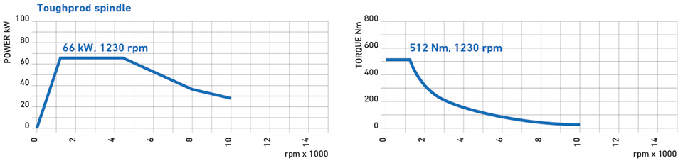

Step-Tec HPC 290 – Toughprod
Dimensions / weight
ø290 x 834 mm / 290 kg
Dimensions / weight  ø290 x 834 mm / 290 kg
Speed (nmax) 10’000 rpm
Torque S1 / S6 40% 512 / 702 Nm
Power S1 / S6 40% 66 / 89 kW
Interfaces SK 50, HSK A/T 100
Mill-Turn function Interlock (SSL) 800 Nm

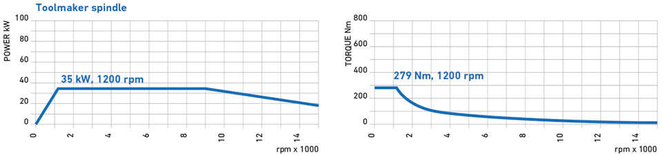

Step-Tec HPC 290 – Tool Maker
Dimensions / weight
ø290 x 665 mm / 233 kg
Dimensions / weight  ø290 x 665 mm / 233 kg
Speed (nmax) 15’000 rpm
Torque S1 / S6 40% 279 / 366 Nm
Power S1 / S6 40% 35 / 46 kW
Interfaces HSK A/T 80, HSK A/T 100
Lubrification oil-air

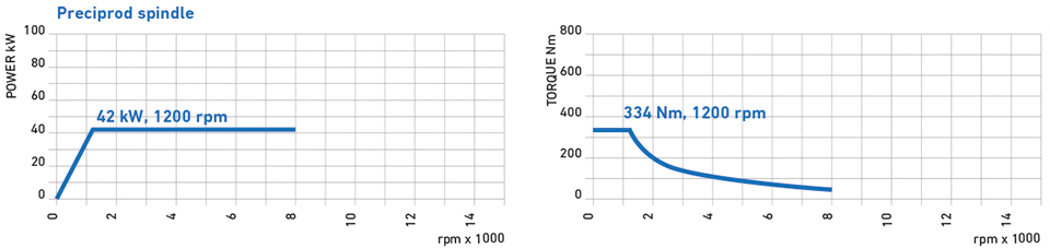

Step-Tec HPC 290 – Preciprod
Dimensions / weight
Speed (nmax) 8’000 rpm
Torque S1 / S6 40% 334 / 438 Nm
Power S1 / S6 40% 42 / 55 kW
