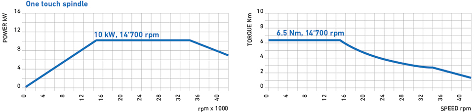

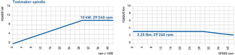

Step-Tec HVC 140 – Tool Maker
Step-Tec HVC140 – One Touch
