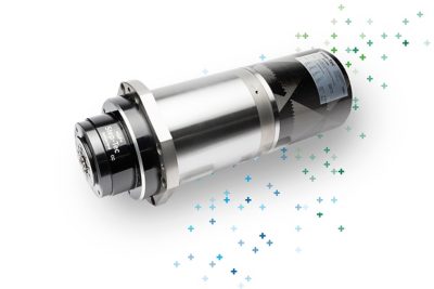

Step-Tec HVC 140 - Tool Maker
Dimensions / weight
ø140 x 480 mm / 36 kg
| Dimensions / weight | ø140 x 480 mm / 36 kg |
| Speed (nmax) | 42’000 rpm |
| Torque S1 / S6 40% | 3.25 Nm / 4.25 Nm |
| Power S1 / S6 40% | 10 kW / 13 kW |
| Interfaces | HSK E40 / C40 |
| Through Spindle Coolant | O, H2O, oil, Co2, MQL |
| Lubrification | oil-air, grease |
| Cooling | OptiCool, Option: CoolCore (Shaft cooling) |
Step-Tec HVC 140 - One Touch
Dimensions / weight
| Torque S1 / S6 40% | 6.5 Nm/ 8.8 Nm |
| Power S1 / S6 40% | 10 kW / 13.5 kW |
