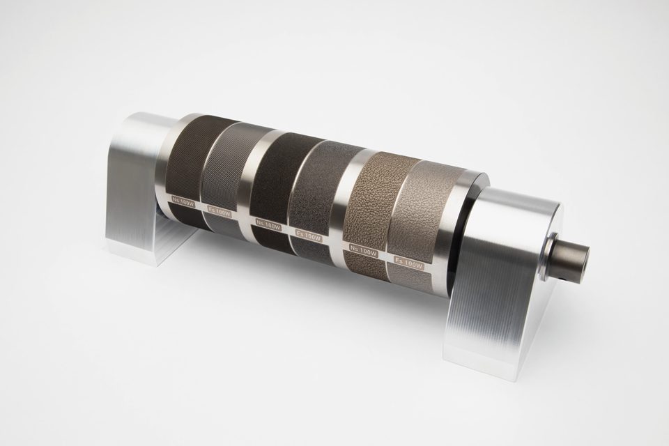

- LASER S 1000 U
- Geometrical patterns
- Perfect texture execution
- Geneva RD
- Digital Technology
- Multi process
- LASER S 1200 U
- New grain
- Large marketing field
- Product design
