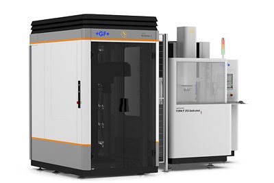

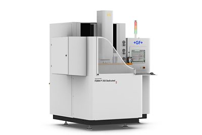

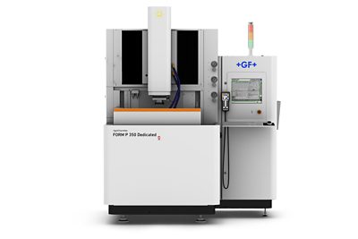

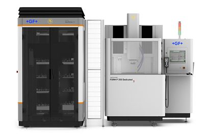

AgieCharmilles FORM P 350 D
Manufacturing connector molds requires high speed and high precision as well as high machining performance. To support mold makers, GF Machining Solutions developed the new AgieCharmilles FORM P 350 Dedicated, a tailored, ready-to-use die-sinking solution for a fast and reliable connector mold inserts manufacturing.
