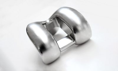

Especially the femoral component in a knee implant, often a chrome-cobalt casting, is extremely challenging to manufacture. The curved, condyle surfaces must meet very strict tolerances and have a smooth, polished surface. The traditional process to manufacture it is to use five-axis milling, which can take up to 75 minutes, followed by five-axis grinding, which can take up to 20 minutes, and then polishing. During this three-step process, the part typically needs to be changed from one machine to the other, which adds additional time to it.
Taking a different milling strategy and using the Mikron MILL S 600 U, along with optimized cutting tools from Seco and specialized CAM strategies developed in hyperMILL by OPEN MIND, GF Machining Solutions was able to not only reduce machining time by over 30%, but also to improve the surface roughness such that the grinding process can be eliminated completely. Implants can go from milling directly to polishing, saving considerable time and cost.
