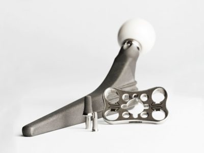

Discover our 3D Laser Texturing on orthopedic implants
UNITED MACHINING' LASER P Flexipulse 5-axis machining center comes with industry-leading software that can create an almost infinite variety of surface structures and textures on even the most complex shapes. Recent tests to measure the ability of titanium textured with our LASER P machine to steer blood-implant interaction and osseointegration yielded results comparable with current industry processes. Our machine brings clear advantages of a single-step surface customization process that is both clean and digitally precise. Other research has demonstrated the ability of surfaces treated with our LASER P to reduce bacterial loading dramatically.

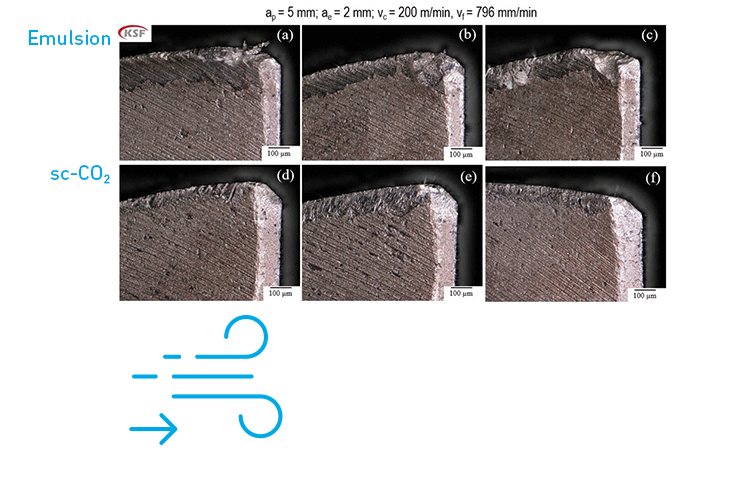

Our Mikron MILL S 400 U 5-axis high-speed Milling machine can be equipped with a technology package that includes a supercritical CO₂ delivery system. Tests performed at KSF (Kompetenzzentrum für Spanende Fertigung) in Tuttlingen, Germany with this combination of technologies show that medical device manufacturers can machine titanium approximately 50% faster than with conventional flood cooling. You can nearly double the life of the cutting tool – all while saving energy!
